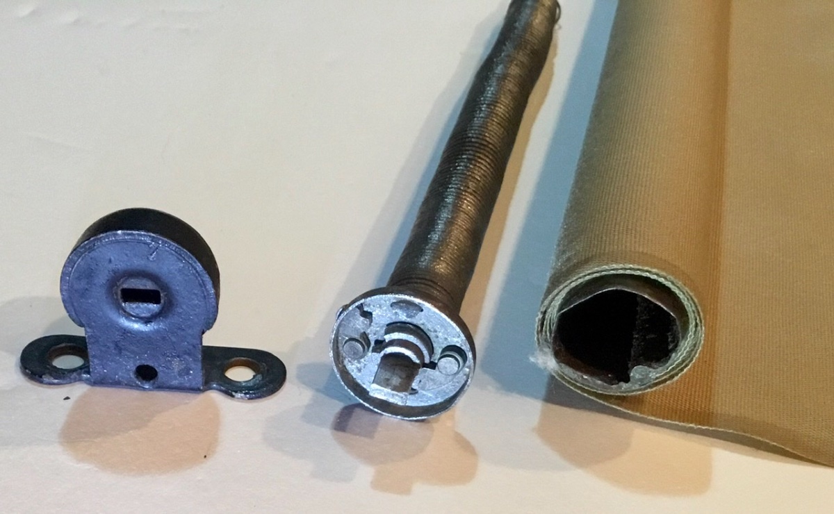

by Humblej
Can you show the other shade parts too please.
Re: 1926 coupe rear shade spring dowel broke.
Posted: Mon Apr 18, 2022 9:27 pm
by jiminbartow
Here you go, Jeff. There are four parts:
1. The hollow metal shade tube.
2. The spring recoil mechanism.
3. One end bracket with a rectangular hole for mechanism.
4. One end bracket with a round hole.
Jim Patrick

by Humblej
Good pictures, thanks, that is helpful.
