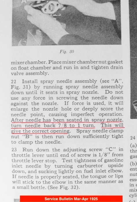

Agree, while most try the wide open 1-1/2 turns, if the carb is fresh rebuild with new needle and seat, the best 'first starts' normally use the Ford recommended carb settings:

Dan. I have a 1926 Holley NH. What type of carburetor is the text in your post referring to? I can’t see the carburetor well enough to see what type it is, but I don’t think a Holley NH has a “spray needle clamp nut”. Jim Patrick

Oh yes, I think it is this:

Your carb is pictured in that 1925 service bulletin, yours has the later 1926 combo needle and choke adj so the needle valve has the brass collar that the twist sleeve mounts on. To keep the needle adjustment from screwing in or out,(engine vibrations), crimp a tiny bit to have the sleeve drag a bit on the collar. The lower hex nut in your arrow should always be snug.
Standard needle with T-top for the forked adj. rod, the Improved uses the same carb, but with a different needle to gain the combo feature.
