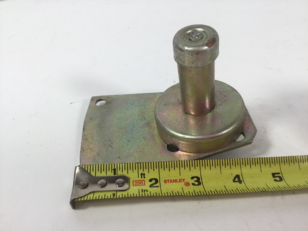

There seems to be some confusion here. The original poster is inquiring about a starter switch, part #5014RE. That's the foot button on the floor. The responses above are talking about the ignition switch, which is on the instrument panel.
Re: LOOKING FOR LANG'S STARTER SWITCH UNIT # 5014RE
Posted: Tue Apr 26, 2022 12:07 pm
by MWalker
Lisa -- The original-type starter switch is prone to failure due to burned contacts, as you apparently already know. A much better solution is to replace that switch with a push-button starter switch as used in cars of the 30's and 40's, in conjunction with a starter solenoid. The push-button switch is usually mounted on the heel panel below the front seat, or on the instrument panel. This is a much better, longer-lasting setup. It does require a bit of re-wiring to install those parts, but it's not a big job. Someone in your local Model T club probably has done this to his car and can walk you through it or do it for you.

I agree 1000% Unless they have changed the guts of the repro switch I would stay away from them.

Adding to previous comments. With a 6v system if everything on the cable to the starter is not squeeky clean, the voltage drop is significant. You can check the switch and they do get a little unreliable. But make sure the contacts are good. Offer still stands, you can have the switch for the cost of shipping, but check your current switch with a VOM just to see if it is getting good contact.

The plunger part and wiring is heating up - causing a short to the starting process - per Martyn - because the unit is flimsy and they do not last? As I am new, I am learning....but I will know more when I am under the car once the switch arrives and i see what he is talking about. The car does start and has - starter itself is a new rebuilt version.

Correct. 5014 is easier to find than the 5014RE but the 5014 is flimsy and prone to failure. you are correct I was not asking for anything ignition related.

My experience with original starter switches is that they are prone to failure after 40+ years of use.
they are rebuildable
I will not likely see the day when one of mine fails again.

this appears to be shorting out to the battery and housing it APPEARS. And the plunger and wires underneath becoming 'hot'. I don't know how old this one switch is. Hmmmmm. I might need to have it towed to the Long Beach guys so they can take a look at it.

Can you post a photo of the current switch, Lisa ? I might have an original, early "take apart" I could send you. Be careful about installing the "less costly" (notice I didn't write CHEAP) as I had one come apart at the top rivet that holds the button and it shorted out and STUCK ON !!!

OK Folks - here are the promised pictures of the starter switch removed. If you look closely, The upside down picture of the base of the plunger unit you will see one half of the metal pieces is missing. That is the piece I sent a picture of yesterday. That piece when dislodged from its customary location was coming in contact with the housing causing the short.
The NEW 6V battery is on a trickle charge right now and it is still showing yellow after 12 hrs. I will leave it on until mid day today and have a friend unplug it for me noonish. I will attempt to restart the car tonight when I get home from work and drive it around the neighborhood for 15 -20 min when I get home from work tonight. Hopefully that will help.

by George House
Lisa- throw that junk starter switch away but retain the trapezoid looking base. Then go to Tractor Supply (TSC) and buy a GOOD starter switch and mate it to that base. Good advice on 6V heavier cables.

I'm back on my soap box.
The switch mechanism that Tractor Supply sells is essentially the same as what is on the repro's that the vendors sell. In fact its also available at most Auto Parts Stores. Now that you realize that, when the switch on the #5014RE fails you can just buy the switch body and replace it on the plate that came with the #5014RE. No need to try an fabricate a switch plate from the old one. Here is what Tractor Supply sells and a picture of the 5014RE for comparison.
Here is link to Tractor Supply https://www.tractorsupply.com/tsc/produ ... tch-dr405c
The switch they sell has a 1 year Warranty :? So save your sales receipt.
Here are some reviews
This is what's inside - look familiar
