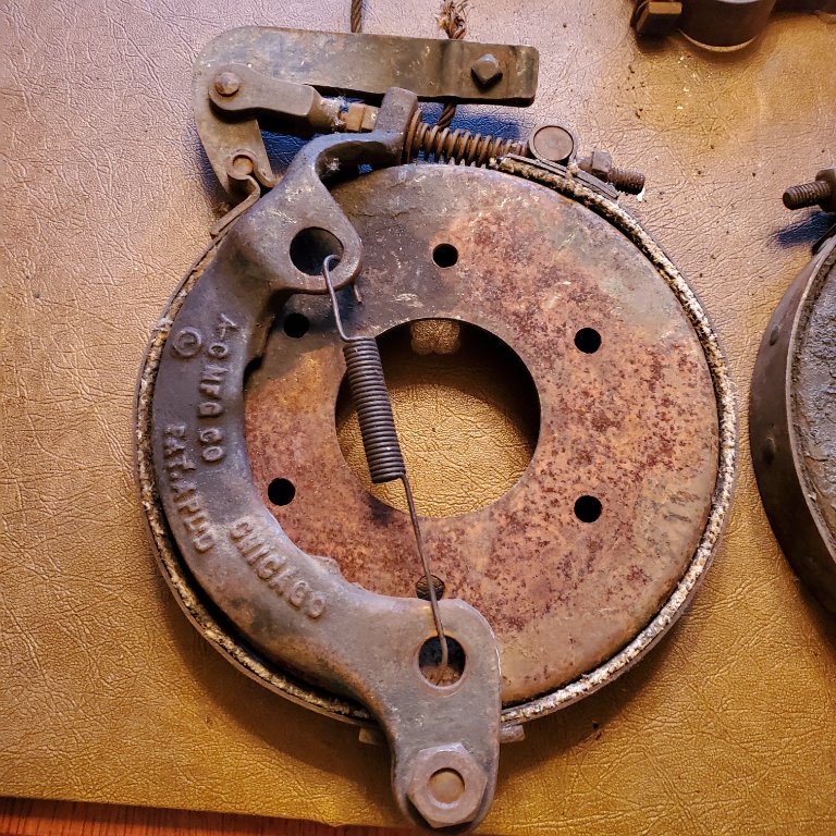

In the process of disassembling and bead blasting a set of original and complete AC brakes. Surprised me how nice they cleaned up. I doubt if I'll even have to to reline them. Purchased a few years ago from Mark at Chaffins. Thanks Mark!

Just picked up the buckboard I had made by the Lancaster area Amish wagon builder ($500). I am converting a 1912 roadster torpedo
to a pick up. It is challenging and fun to creatively put a 1914 gas tank under the seat, drill holes for the battery box, 1927 engine from Ed Henline,
selling the 1912 rear to replace with a ruckstell, disc breaks were put on last fall, demountable,.............
I bought the car as a project car which came with many parts. I sold many parts at Luray and made just about enough to buy a Ruckstell.
I don't want my estate to sell my parts. I am selling my parts now to make money and to put back into the T!
