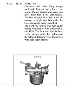

That Ford F is an HN Holley design, that Ford made under license from Holley, during the twenties for a time Holley could not keep up production, so Ford made these. Same parts as the NH.
Image 5-6-22 at 9.50 PM.jpeg (32.22 KiB) Viewed 1398 times

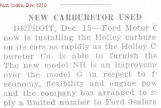

Here is a tidbit, note the comments that Ford is using the New Holley NH on all production, and that Holley was building them fast as they could, guess not fast enough, so Ford got involved and made some too!
