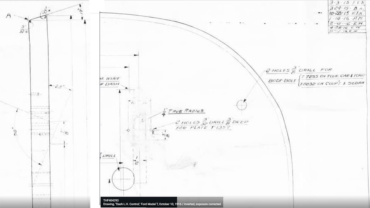

Can't figure out why this is bored into the engine side of the this firewall....what's it for? It is only 5/8's deep and it does intersect the mixture control rod that passes through that slant drilled hole. Is there some sort of vibration damper that fits inside to keep the rod from turning on it's own whilst the car is traveling? You can see it appears on the same centerline in the side view too, and the dimension on the side view is 5/8's, so it is that hole. The one below and to the left of the slant drilled hole is for the light switch for magneto headlights.
Does anybody know whether or not this hole is really there, I asked Steve Jelf (who kindly furnished me this drawing), and he didn't know nor is it on his firewall. I'm beginning to think that this is the last change as noted in the upper right corner "2-11-16 E.W.", because we know that the first 1915's had gas headlights and that changed sometime later in 1915, so the change made in 1916 has nothing to do with the headlight switch hole which is 7/8" and appears to the left of the Mixture Rod slant drilled hole. And since it doesn't appear on Steve's 1915 which has mag headlights, it must of been added later. I need to know when (which is early 1916 I suppose) and why, as in what the hell goes there?
The notation says "3/4 DRILL 5/8" DEEP IN FRONT SIDE OF DASH" (that's the engine side, this drawing view shows the interior side).
I can't for the life of me guess what it's for.

Does it provide the needed clearance for the lower part of the mixture rod to clear the wood?
Otherwise a dampener washer sounds like a good guess.

IF, the adjusting rod was changed to the later type (1917-1925) around the time (2-11-16) it might be that clearance was needed to install it. The brass knob is removable to install the early type.
That seem a logical reason for it to me.

Richard, this is a straight bored hole 5/8 deep with a 3/4 drill bit....it is located (as per the drawing)
It appears about halfway up from the lower exit for the Mixture Rod hole and you can see from the portion of the side drawing, that it intersects with the slant drilled hole which is drilled at 21ยบ....it is clearly not for clearance nor can you thread the fork end through it, so what it is for, I can't figure out. Other than possibly something suggested by "Speedytync.....Otherwise a dampener washer sounds like a good guess." But it doesn't appear to be deep enough for a washer, so is there some rubber plug that fits into that hole that would work as a "dampener"?
This obviously didn't appear on any of the 1915 cars (being a correction made in Feb of 1916), so if it showed up at all, it would be in 1916....is there anybody out there with a 1916 that has this hole in their firewall and if so, what goes there? Or is this one of those "Better Ideas" that Ford scrapped before it even made it to production.

Martynn, you should know by now better than to ask me a question. I don't often have the answer but bring up several more questions.
I read the drawing as 3/8" deep rather than 5/8. I know that doesn't help any. :D
To add to your frustration, I found an October, 10th, 1916 drawing with a different configuration there. It is not clear but presents a later configuration.
Here is a March, 3rd, 1915 drawing. Although it is of the square dash before the cowl was added, it shows the angled holes on both sides of the dash. T
No doubt only one hole was drilled depending on Left or Right hand drive.
These were on thehenryford.org/collections-and-research site and can be viewed and zoomed in on. They aren't as clear as I would like.
Happy Puzzling.

Richard, looks like whatever E.W's. change he made back in Feb of 16, he erased from his Oct. 16 drawing (pretty sloppily too), was this drawing marked anywhere on it as "Obsolete"? Because he didn't put the hole for the mixture rod back in when he made that change. And yes that now fictional hole is drilled by a 3/4 drill 5/8 deep....he makes his "5" all the same way and everyone of his "3" have a round top, not flat....only the 5"s have that flat top. The other thing you've got to take into consideration is that Engineers and Draftsmen used pencil back then, not ink, like "Chicago House Illustrators" in their advertising department did. And graphite pencils then were a bit different from what we've got today (they typically used anything from 9B to 9H) and tend to smear (a lot, depending on their softness) and E.W. drew in a #2B (which was typically used for layout work and sketches, but if you wanted your lines to be dark, then a softer pencil allowed you to draw the line without needing to fortify it with more pressure or more strokes), not 2H, so the smear factor was much higher than it would've been today (even with a "dead rat"...trade talk for a bag filled with fine eraser crumbs that leaks through the weave of the bags cloth to keep pencil lines from smearing on your drawing, also known as a scumbag).

I'm an old draftsman too but not that old. I do still have some of this.
The details become "Curiouser and curiouser" don't they?
