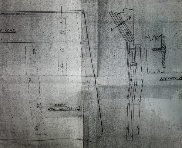

				Robert,
I spent some time at the Benson Ford Research Center studying the 26-27 floorboard drawings. Here is part of the Ford factory drawing for the lower floorboard assembly called "Front Floor Board #3". It is a one piece fully assembled and painted part before it is installed on the assembly line in the car. Drawing shows the end grain wood splines, steel angle brackets, wood stringers, etc. The factory drawings made in 1925-26, the floorboards were made of random width boards jointed and glued together, in 1927, plywood was added as an acceptable wood. I suspect from your pictures your floorboards are not original Ford. You should see evidence of the 2 wood braces that were nailed to the bottom, evidence of the 3 metal brackets or screw holes, as well as wood splines in the end grain. The middle floorboard called floor board #2 should have a 1" finger hole for removing and installing the floorboards as well as the end grain splines. Floorboard #1 also has end splines but no finger hole. Hope this is helpful to you.
				Re: Rear Floor Board Question
				Posted: Thu Jun 02, 2022 7:25 am
				by Moxie26
				Jeff... Since you know so much about your findings from the Ford research center, why don't your rear floorboards fit properly?  .....
				Posted: Thu Jun 02, 2022 7:40 am
				by Humblej
				"Jeff... Since you know so much about your findings from the Ford research center, why don't you rear floorboards fit properly? ....."
Robert, I think you have me confused with the other Robert (Mopar-Man), the original poster. However, this is not the first time real hands on research thru Ford factory drawings has been met with hostility and doubt. Use or ignore my findings as you see fit. Hope someone will find it helpful or at least interesting as I do.
