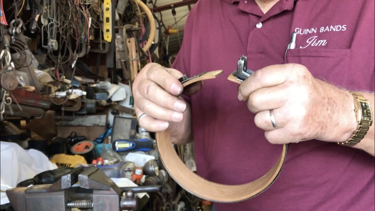

by jiminbartow
I’m in the Guinn’s wood band camp. Jim Patrick

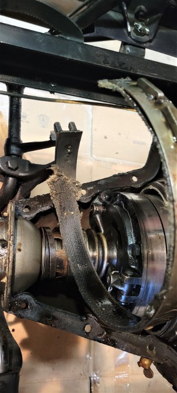

Richard-
I'm in Allan's camp, too.
The previous owner of my 1911 used old Scandinavian lining and now I am replacing them with Kevlar.
I would put the cork transmission linings on the display shelf, right next to the historic Scandinavian.
Since you have an aversion to Kevlar, I'd suggest you get new Scandinavia linings if you plan to drive your car.
Your mileage may vary.
Keith

Keith, your bad lining torn or worn off at the top is exactly what my brake band looks like. I wore it out on a hilly tour last year after I was falsely reassured it was flat land. I found most of those on the tour were set up for the challenging terrain in that they had auxiliary underdrives and outside brakes.
Although I had a Ruckstell and used both reverse and slow speeds bands to slow the car, the terrain proved too much for the Scandanavia lining on the brake band.

KWTownsend wrote:
Sun Jun 05, 2022 11:01 am
Richard-
Keith
There appears to be remnants of a gasket between your 4th main & drive shaft flange. There should be no gasket here. This is a ball joint & an unneeded gasket adds extra looseness. In fact, most are a bit too sloppy from decades of wear & can use a ball shim.

I had probably had only a couple of thousand miles on those bands. I've had it on the road since the 2013 Kanab Tour and have been on a couple of Annual tours, but of course sometimes drive different cars for different occasions. I could tell the brake was getting bad pre-covid, so lined a set of bands with Kevlar in anticipation. However, last year on the tour in Spokane, is when I really noticed the fading.
John-
Your observation is very astute. I also noticed it when I was taking the hogs head off.
