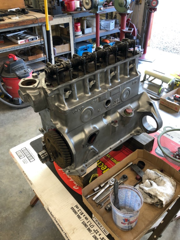

Pre 1975 Volvo's for the most part all had Gyptal coating applied at the factory on the inside of the engines and transmissions. Now you know why they have broken world records on the most miles. Applied correctly it will not insulate but cause a non-stick surface to prevent crud build up.
People have ask me for years how my engines are painted on the outside because my paint never peels off. Surface prep is the most important. Sand blast the outside after sealing very tight, Scratch wheel on a drill, Wash with mineral spirits 3 time with a solvent wand. Let dry in the sun, blow dry, wipe masking areas with lacquer thinner, mask, mist coat with high engine primer, paint. Let cure for 2 days. ENJOY YOUR NEW CLEAN ENGINE FOR MORE THAN A LIFE TIME!
