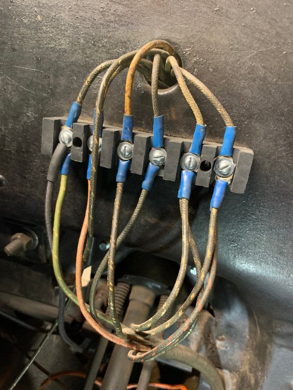

Mixed Up Wiring
I wanted to add this to my post on generators & magnetos, but it won't let me. I can tell that my Ammeter is wired wrong because when I turn the lights on with the car not running it shows a 'Charge'. It's odd to me that regardless the needle doesn't fluctuate with throttle changes. Also, I printed off the PDF of wiring diagrams and mine don't look like them. Maybe the color has faded?

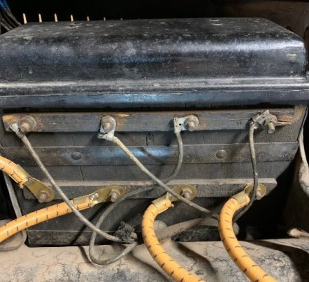

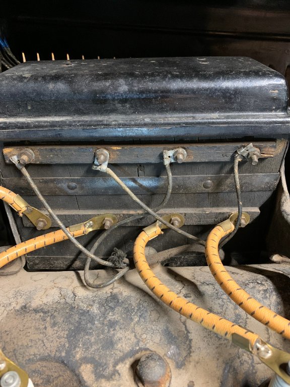

The coil box from Hell....

Re: Mixed Up Wiring
Read the following, conduct the two tests for correct charging/discharging wiring and fix it.

Re: Mixed Up Wiring
"It's odd to me that regardless the needle doesn't fluctuate with throttle changes." //// That probably indicates that the generator is not working, or the cutout is not workinbg, or you have a bad connection. The ammeter is evidently wired backwards, assuming your battery is connected properly, with the negative post grounded. When the engine is off and everthing else turned off, does the ammeter needle stay in the middle, or very close to it? (The coil box and wiring need some attention, but I wouldn't let that discourage me)

Re: Mixed Up Wiring
The needle never moves ( I didn't look when starting) in either direction unless I turn the lights on then it shows a 'Charge'. Which would indicate that it's wired backwards. Otherwise it stays in the middle. The battery must be getting charged because I've owned this since April and it never fails to start and I've never put the battery on a charger.TXGOAT2 wrote: ↑Fri Jun 17, 2022 3:24 pm"It's odd to me that regardless the needle doesn't fluctuate with throttle changes." //// That probably indicates that the generator is not working, or the cutout is not workinbg, or you have a bad connection. The ammeter is evidently wired backwards, assuming your battery is connected properly, with the negative post grounded. When the engine is off and everthing else turned off, does the ammeter needle stay in the middle, or very close to it? (The coil box and wiring need some attention, but I wouldn't let that discourage me)

- Posts: 6790
Re: Mixed Up Wiring
ammeters for your year car are notoriously unsensitive. They rarely show the discharge from coils vibrating, and the starter is not included in the ammeter circuit, so short of turning on the lights, you're not necessarily going to detect anything. Once you're on MAG, if the lights are off, you are drawing ZERO current from the battery.
for the infrequent starts over the last 2 months, and minimal drives you've done it is entirely possible that your generator is not charging and you're still just running on the battery. Sounds like you at least have a good starter and the car starts quickly enough to not draw the battery down much.
folks often don't realize that they can start and drive the car for miles and miles, with the lights on to boot, and not draw the battery down too significantly if it's a fresh battery
Follow Ron's advice, and report back in a day or two as to what exactly is wrong.

- Posts: 4462
Re: Mixed Up Wiring
Don't take that too much to heart...
At some point, the coil box should be rebuilt. Don't worry about that now. What you should do however, is re-route the wires coming from the timer to the coil box, so that they're not touching, or even near, the spark plug wire terminals. Easily done with zip ties or similar.

- Posts: 4694
Re: Mixed Up Wiring
If your wiring looms are of the correct colors, then check each end of each wire to be sure it goes to the right terminal. If they are not in the correct location, fix the. However if your loom is not standard color code, then check each end of each wire to be sure it goes to the corresponding terminal to the other end of the wire. On that coil box, move the low voltage wire away from the spark plug wire so the spark does not jump to the wrong location.

- Posts: 8636
Re: Mixed Up Wiring
The condition of that coil box could explain a number of issues this car is having. Some TLC could probably improve its performance without spending money. If the inside of the box and the coils within it are in the same shape as the outside, it is in serious need of inspection and clean up. The engine cannot run any better than the ignition system performs, no matter how good the engine is.

- Posts: 6579
Re: Mixed Up Wiring

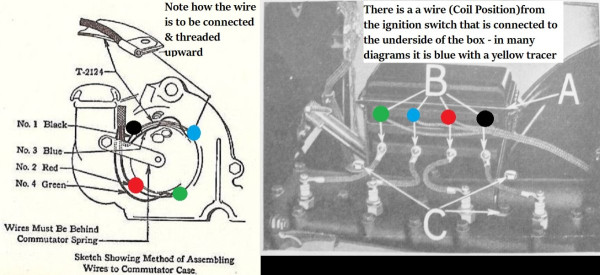

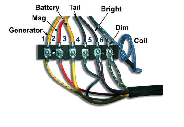

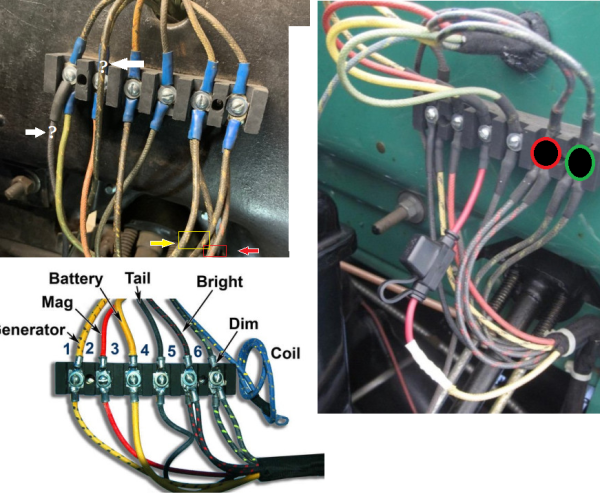

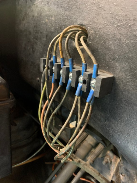

Wire colors are meant to help connect wire ends to their proper position. In looking at the terminal strip and wires coming through the firewall there are some issues to contend with.
The first is that your wire colors don't all match the bright colors in the wiring diagrams. As a result you need to disconnect one at a time and test the other end for continuity. Once done you need to tag or somehow mark both ends. Don't use numbers as they will confuse you with terminal positions) perhaps a letter and then record what its connected to at the other end (not the terminal block end).
In looking at the pictures posted there are some questions about the headlight wiring connections at the terminal block and if the correct wiring is correct. It just adds to the confusion --
The coil box wiring looks incorrect based on wire length. Now someone may have corrected an error in wiring the commutator ends of those wires at the coil box but.... I would clean the ends of those wires and check the commutator connections and place wires were they are supposed to be an not adjust for an error

Catguy
The Ammeter needle not moving when the engine is revved up is an indication of yet another charge/discharge circuit wiring problem.
It is those five pesky charge/discharge circuit wires that are commonly wired incorrectly.
It usually takes about five minutes to correct these problems.

- Posts: 8636
Re: Mixed Up Wiring
It looks to me like your car has a number of problems that may have simple cures. For instance, the coil box wiring has the primary wires touching the spark plug wires. That would probably make a brand new car run rough. The cure is simple: Move the wires away from each other. The generator problem may also have a very simple and inexpensive cure. It's likely that your car has a number of bolts and screws that may need tightened. Most Ts need many parts on the chassis and body lubricated. This kind of attention is not expensive or difficult to do, and it can make a dramatic difference in how the car performs. I've bought many old cars, some from junkyards, that would not run at all. In many cases, a little effort and a small outlay of cash got them in good running order.

Re: Mixed Up Wiring
1) Consider a new wiring harness
2) a timer wiring harness
3) a new firewall junction block
4) and replacing coil box wood with the plastic wood kit
4 small jobs that will make a huge difference for you, so you can get back to having fun again. Or do as George M. advises.

Re: Mixed Up Wiring
Scott,
I had a charging issue just like yours... backwards ammeter gauge and no charge visible on ammeter needle.
Backwards ammeter because it's a (+) positive ground gauge. Rewire it or live with it.
My Generator was not showing a charge because it was set to 4 amps on the bench by the rebuilder. So mine is set too close to neutral. Yours could be just a 3rd brush adjustment like mine is.
Good luck and have fun working on your car!

- Posts: 5248
Re: Mixed Up Wiring
Thats an old repop harness. My concern: is, are the ends soldered or just crimped? Crimp only connections tend to fail over the long term. I have had some cheaper made harnesses & soldered all the connectors before installing.Professor Fate wrote: ↑Sun Jun 19, 2022 9:28 amI think replacing the wiring, coil box wood for plastic, and the junction block is best. Rewire according to diagram and diagnostic test only if an issue pops up.
