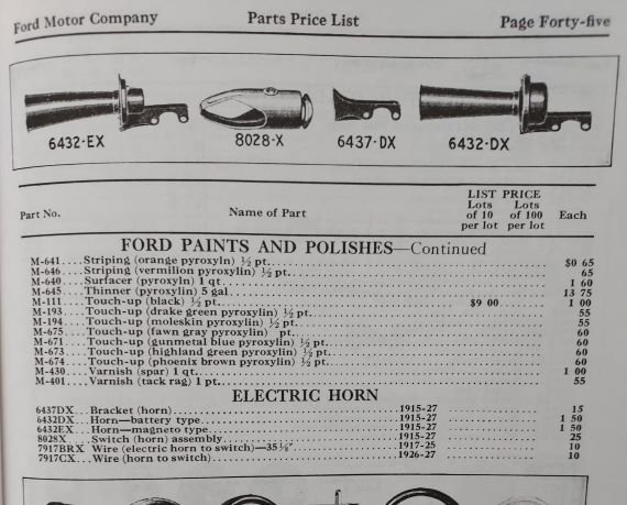

My 22 starter car did not have a horn when it came but I do have a hand operated klaxon and a magneto horn on hand (a little worse for wear and with a few dents that I plan to smooth out). Some checking showed my car was made January 11, 1922 and the battery horn came out after that, so it would have had a magneto horn. All to the good.
My mag horn has the mount for attaching it to the firewall see below). But, in looking at different books and photos in the Ford shop manual I see variations in how it is mounted. Some pictures show what look like small spacers between the horn and firewall. Others appear to show no spacers. What’s correct for 22. Also, my horn is the earlier type that has two wire attachments. From what I have read, one of these should be grounded to the housing and the other should be the hot, which runs off the mag post, to the horn button then down to the horn. Do I have all that right? If yes, Can I connect to the mag at the junction block or should I run a wire straight to the mag post?

I believe the answer is your mounting bracket is wrong for your year car. After starters became an option with some cars using a mag horn and some using a battery horn, the horns were different but the brackets were the same. Looking at the 1928 Ford Parts Manual, the mag horn and battery horn both had the same 26-27 mounting bracket and that latest version of mag horn was a retrofit item back to 1915. Of course that was not the mounting bracket used originally in 1915, but it would certainly work as a replacement on cars 1915-1927 as the water inlet mounting holes are the same. Also, a wood firewall mounted horn would need a seperate ground, an engine mounted horn would not. Anyone with an earlier parts manual should be able to verify the correct bracket pre 1926 improved car, but I suspect you need the bracket that uses one head bolt and one water inlet bolt.

Jeff's info is correct.
And here are the dates for the 1922 magneto bracket change to mount that horn on the engine instead of the firewall.
The magneto horn was mounted to the firewall using the flat five-hole bracket (T6437A) until about 4/26/22 when the battery horn first appeared. The battery horn was also mounted on the firewall using an offset bent horn bracket similar to the five-hole flat bracket except for an offset “z” bend in it. This bracket was T6437B.
On 5/17/22 a new bracket T6437C was designed and this is the common motor mounted horn bracket used on both the battery horn and magneto horn through 1925.
. B. McCalley CD Encyl.
