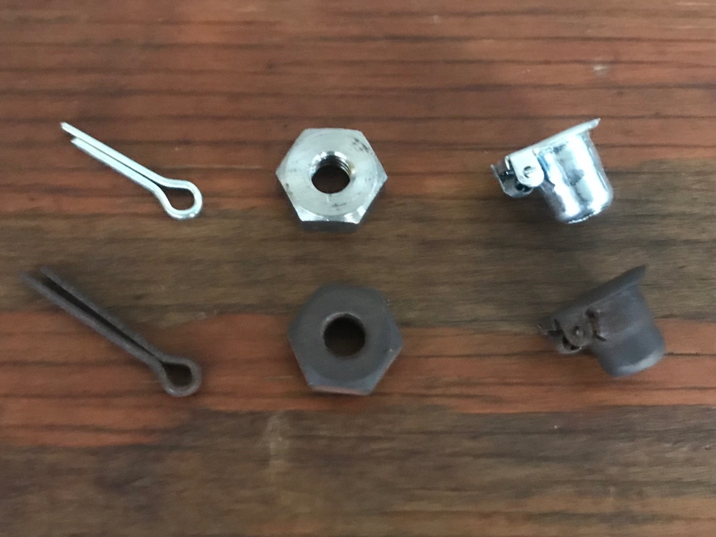

The pieces I have worked on are a zinc plated cotter pin, a raw nut, and a zinc plated oiler.
The photo makes the bluing look better than it is, they are gritty with rust. I am using Birchwood “super blue” which was advertised as being darker than their standard bluing.

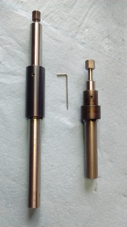

these two tools show the difference in amount of heat applied vs the color that resulted. They were made years ago and just taken out of storage to help another "T" guy with details of their manufacture...they still look like the day they were made

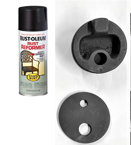

You might want to look into this Rustoleum product RUST REFORMER about $5 - not to be confused with their Rust Inhibitor
"Stop rust in its tracks with Rust-Oleum® Stops Rust® Rust Reformer. A layer of this flat-black coating bonds with rusty metal and instantly transforms it into a non-rusting surface. No need to sand down to bare metal, simply spray directly onto rust."
- Attachments
- rust reformer.png (201.97 KiB) Viewed 2817 times
