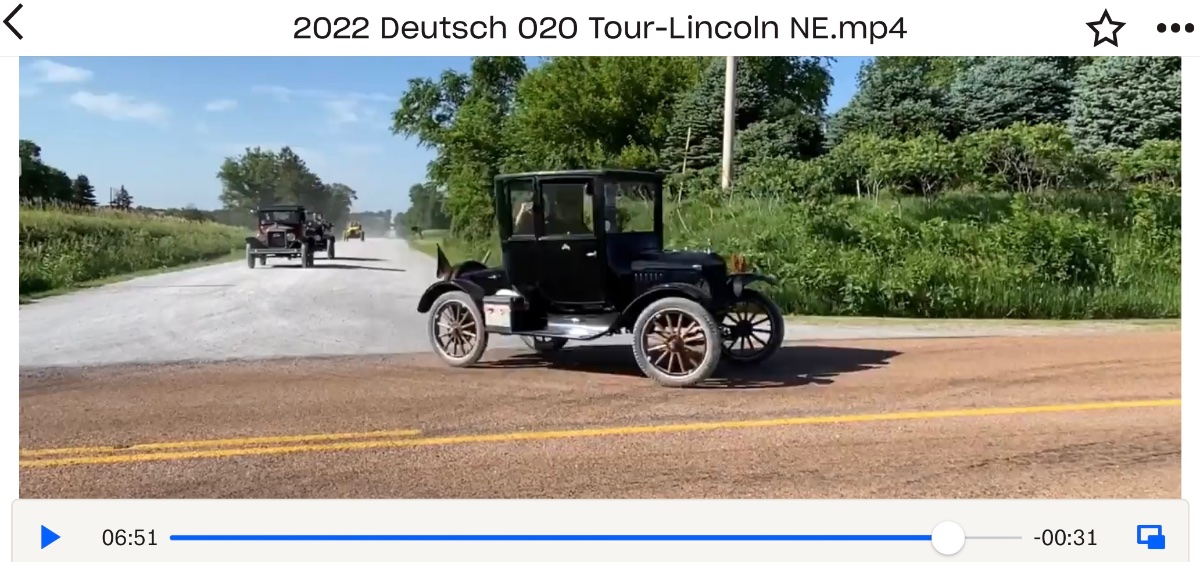

This video shows all ten, in their five T’s, heading west onto U.S. Highway 6 just west of Lincoln after leaving Myron and Barb Smith’s place this morning. Just as on the original Ocean to Ocean race in 1909, there’s a Ford Model K piloting the start. As it should be….. 8-)
Click on the blue link to see the video:
https://www.dropbox.com/s/5xxaq46smq9xn ... M.mov?dl=0

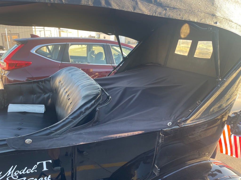

Regarding the covers
That‘s the cover for the back of the touring, prevents loosing stuff while driving, but also hiddes the chaos in the rear
That’s the night cover
