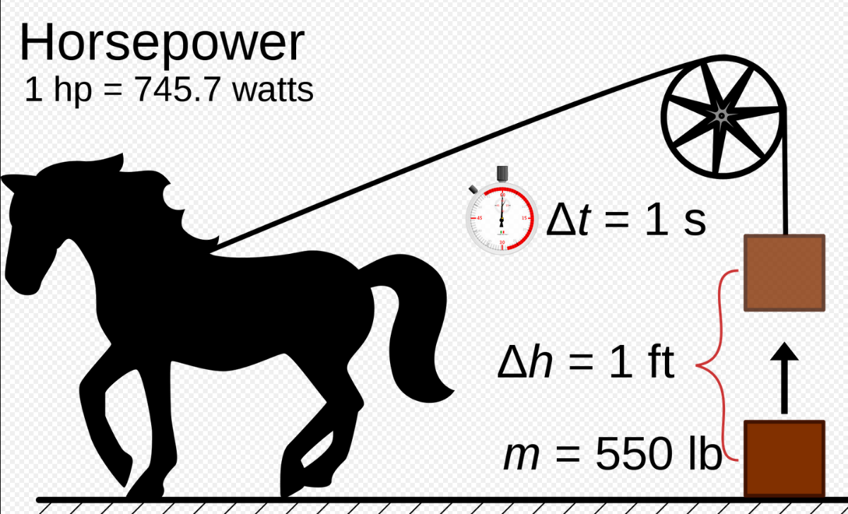

Re: 20 horsepower !
Posted: Fri Jun 24, 2022 12:03 am
by BobD
