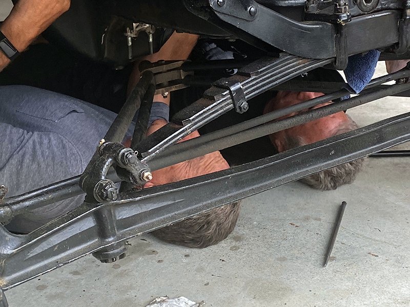

Carole King's song "You've got a Friend" applies to the times in the Model T world when you can use some help. A little over two weeks ago the flywheel under discussion above finally gave up the ghost, setting into motion an extraordinary series of events, all aimed at helping me get back on the road. I am truly humbled to have friends who are there when I need them, and wish to acknowledge them here
The list is pretty long but Charlie Volkening and Tom Graham rebuilt my transmission and checked over my engine in record time. Don Booth served as a way-station in getting my engine to the North Country to be rebuilt. Dave Nolting who trusted someone he'd never met enough to ship out a set of new drums before he received my check so that I wouldn't be held back waiting for them. Denny Newman shared his knowledge and advice on a couple of issues that could have developed into additional troubles. Gene Butler has been there for every step of the process as has Brian Dowell who provided much of the tools, expertise and energy to get the job done. Tony Osentoski, Ron Stratton and Wayne Lepola did not hesitate to get greasy and lend a hand where needed.
The result? The engine is back in the car and I am in the process of hooking things back up and getting ready for a road test and further adjustment. Thanks to all who helped, I hope I can be as good a friend to you......
Wayne, Gene and Brian making sure the engine goes in smoothly. Ron is underneath fitting the universal into the engine
Wayne and Ron working on the hard to get to bolts
