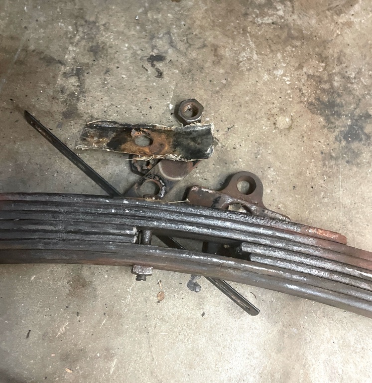

On the '27 the steering has been a bit quirky at times. Have always checked the obvious pieces of the front end, steering gear, king pins, spindle bearings, air pressure in tires, spring hangers. etc. etc.
But garage time today, jacked up the chassis, and pulled the wheels for tour inspections and grease, and noticed the spring stack would slightly wiggle, as one or two leafs could be displaced. Odd.....
Note the shift between spring leafs.
Well, removed the very tight front spring clip to allow the spring to drop down to inspect
Oh my
Now I know the source of odd wiggle squiggle. Odd too, no pieces of those leafs were in the crossmember, must be somewhere on a road...UPDATE. didn't look close, but the busted ones just slide to one side, taking the spring clamp too, funny never noticed the longer leaf on the left side
...on with the fix with a new T-Springs front spring, those old 100 year old leafs can't last forever
