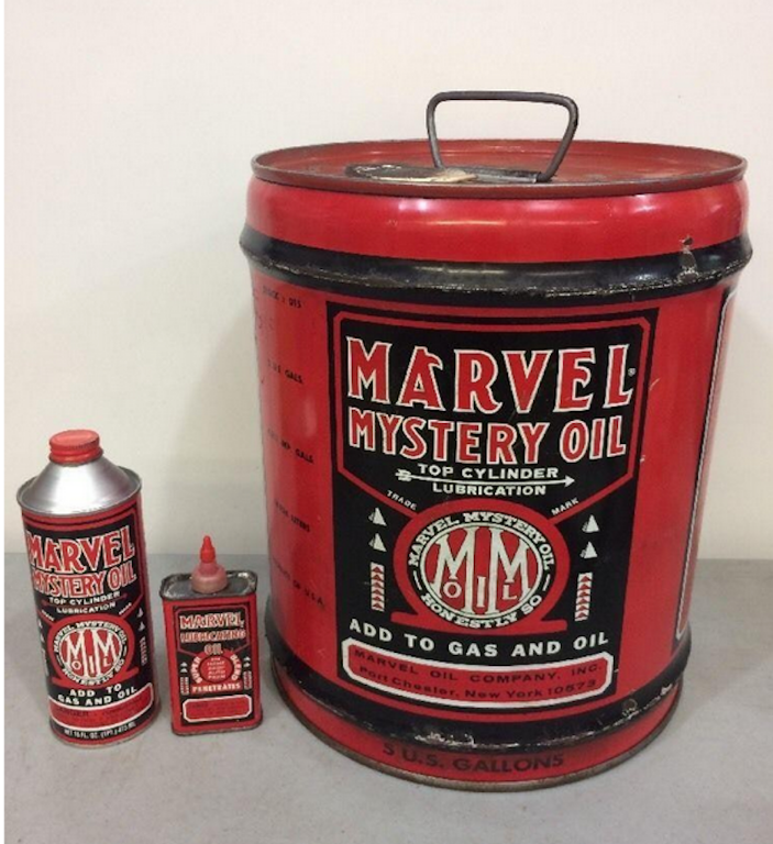

by TXGOAT2
Soak your rusty old rims in Marvel Mystery Oil for a week, then file all sharp projections down smooth, keeping your single cut file wet with MMO. Then wash the rims with solvent and bead blast them. If they're really pitted, you might use high build primer on them, or Bondo them, then smooth the Bondo with a body file. Another option would be to bead blast, then have them hot dip galvanized. Heavily corroded rims are best replaced, if possible.

by Steve Jelf
One gallon per quart of oil will keep your valves free
This oil.
