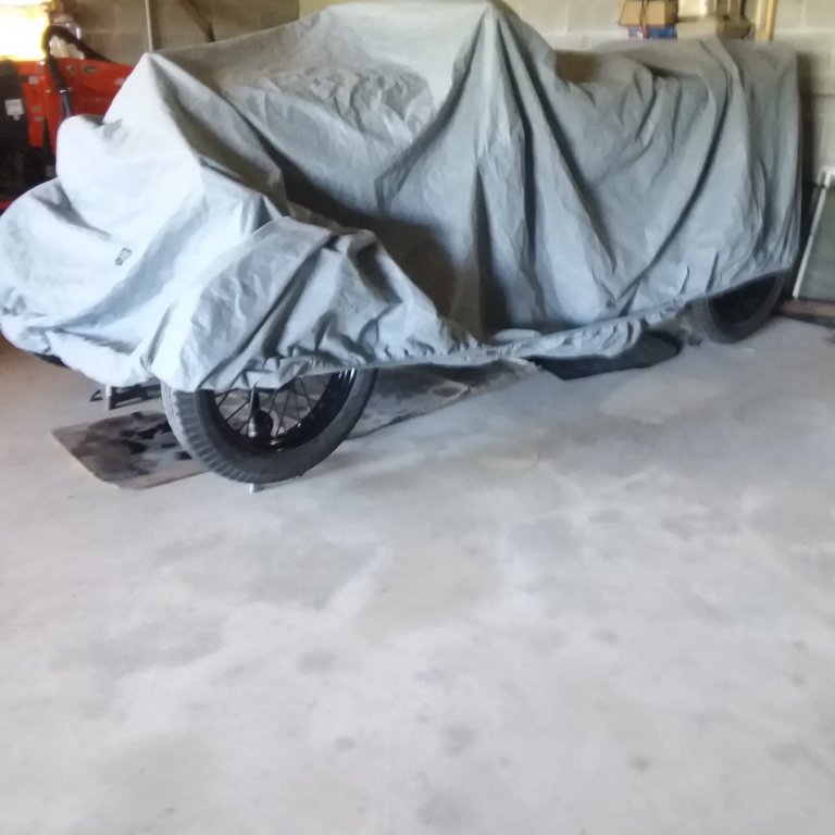

So.... I pulled and cleaned the mag post. Nothing on it. Spring on post is nice and springy. Checked the wire on the coil box and the back of the switch. I've cycled the switch. No improvement. Car will die when I switch to mag.
I don't get it.... This thing was running perfectly then it just went to sh#@%t. My rebuilt engine runs perfectly. It's a dream to drive. Mag just ain't workin'.
Mag test light still glows, but goes almost out when I switch from battery to mag.
The car's on jackstands and covered up. I've had it.
