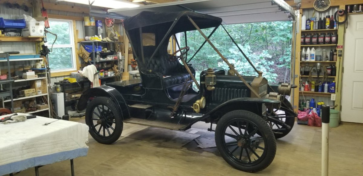

When not playing with my 1913 or 1915 Ford's, I'm working on my 1911 Model Q-11 Maxwell. The car is very complete but it underwent an "incorrect" color restoration in dark green and black, back in the 1950's (It should be light blue). In any event, I have the brass windshield but the long brass support rods are missing. I figured Lang's made something for the 09-12 Model T that I could adapt, but saw nothing in their catalog or the website. So the million dollar question is: where does everyone get them? Are we left with making them from scratch? Your input would be appreciated.
