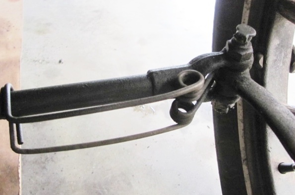

The small double end with curve rests into the yoke of the connecting rod between the spindle arms. The long trailing rod ends ride in the back side of the axle channel. They work to try to take out the Ford's Shimmy Shimmy :lol: Have seen axles where these were used, and the hardened spring steel rod ends groove the axle.

Here is the more common version, with hooks that cross over the connecting rod, these tighten up the spindle arm bolts, to keep wiggle down. They are on my '23 cutoff and have been there since so long ago, the spindle arm is worn to match!
