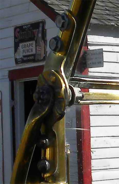

Could someone send me pictures of the Rands Hinge mounting to the windshield frame from the back/inside side showing the hinge to upper and lower frame location. Also, the centerline location dementions of the mounting holes (from the flat of the frame). I am using a reproduction frame with original Rands hinges and I guess I have one shot at getting the hole and hinge to frame location correct. Any help would be appreciated. email: astein.pls@gmail.com

Does this picture from Royce help or is '11 totally different?
http://www.mtfca.com/discus/messages/80 ... 1242320404
or maybe this by Garnet?
http://www.mtfca.com/discus/messages/25 ... 1333701125

Rands hinges

Thank you everyone who responded with pictures. The detail helps immensely on the assembly of the hinges to the frame.
