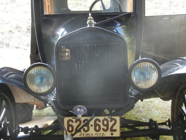

Any one know of a source for blue tinted six volt head lamb bulbs?
I need to find spares and a replacement for the 1922 Coupe.

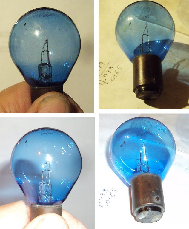

Re: Blue tinted Head lamp bulbs
The blue bulbs are a delightful thing. I took some photos of mine to show those who haven't seen one up close.
I thought I had a box of them but haven't found them yet. I'll keep looking.

This is not a head light bulb. Notice the single filament. Note the 2 contacts. these are + & -.The pinned brass body is not a ground.
This is an old spotlight bulb.

If pinned body is not grounded then that would suggest wiring in series for a non-starter - magneto bulb.speedytinc wrote: ↑Tue Aug 30, 2022 12:23 pmThis is not a head light bulb. Notice the single filament. Note the 2 contacts. these are + & -.The pinned brass body is not a ground.

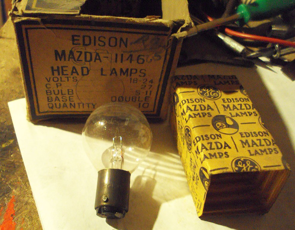

Thanks Frank. I have several boxes of clear ones like that and the box is marked Headlight Bulbs. I had thought they were Mag bulbs also. Sorry if I have confused anyone.
