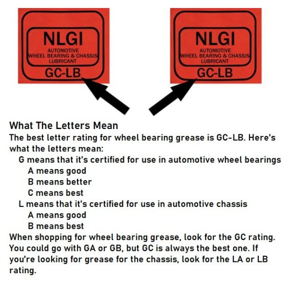

- Posts: 6419
Re: Grease Calling all Chemical engeneers
Gathered information  from various sources on the Internet
Color - https://www.mcphersonoil.com/does-the-c ... se-matter/
Color isn't an indication of grease performance and often dyes are added by the manufacturer to help users distinguish one from the other
In the Mobil line, there are many different colors used:
-Dark blue – typically for multipurpose greases made from conventional oil base stocks
-Red – mostly for multipurpose synthetic greases
-Grey – for those containing moly for many off-road equipment specifications, and
-White or undyed greases – typically used in paper machines or food-grade applications.
A good article on Today's vs past formulations https://gmb.net/blog/a-guide-to-wheel-bearing-grease/
What The Numbers Mean
Each bearing grease type comes with a numerical rating that indicates its thickness. Bearing grease comes in a wide variety of thicknesses. The numerical rating helps you pick the best one for your application.
Most commonly, the numerical rating ranges between 0 and 6. The 0 rating indicates that the grease is soft, in an almost liquid-like consistency. The 6 rating indicates that the grease is quite hard, with a consistency that’s like a firm cheese. Most wheel bearing formulas come with a rating of 2. This indicates that the consistency is similar to peanut butter.
Why You Should Not Mix Together Different Types Of Wheel Bearing Grease
You can mix together some oils used in bearing grease. For example, plant-based oil and petroleum-based oil can mix freely with each other. If you want to know if the new bearing grease will mix well with the old bearing grease, you need to do some research.
If you ask us, though, it’s always better to play it safe. If you mix together two incompatible types of grease, your wheel bearings can fail. It’s because not all soaps are compatible with each other. Mixing together two different types of soap can result in the soap separating from the oil. This will render the grease useless.
