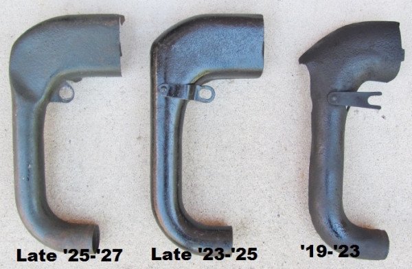

There are several versions of he hot air pipe - I am in the process of adding them to the classifieds
