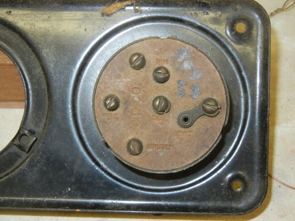

by Been Here Before
Do with this as you want.
A previous post of the interior, back panel of a Model T Ford switch. To my knowledge this is the black as it came from the factory.
Yes, this is possible an original factory black.
(I would guess with the modern paint analysis to match, it may be possible to approximate original factory black from this piece.)

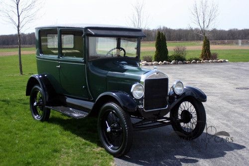

Re: Paint question
Posted: Tue Aug 23, 2022 10:31 pm
by ThreePedalTapDancer
Looking at this photo the body does look satin while the fenders appear glossy.
