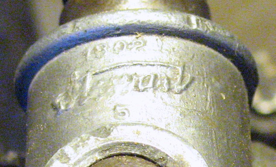

I have my speedometer installed, but I haven't connected the cable to the swivel because of a malfunction. The swivel turns CCW, which I believe is correct. But it turns only when the wheel rotates backwards!
Have I installed the gears and swivel incorrectly?
Do I have the wrong swivel?

Something is wrong with your internal gears. Turning your wheel in either direction should make the swivel output shaft turn. Give me a call since your email isn't working. Russ Furstnow
