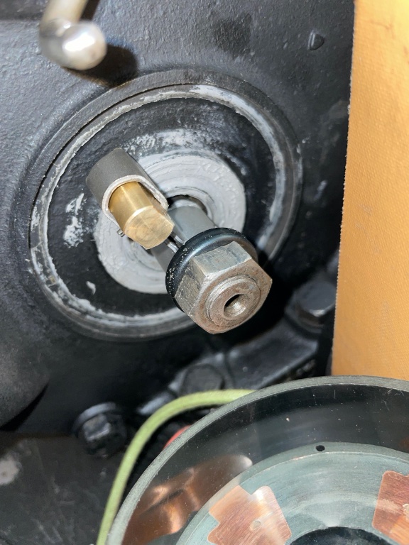

I installed a brand new New Day timer just prior to the Hamilton, Ohio tour and it performed well for that tour with the exception of the last day when I developed a small skip. I installed my spare set of coils at the lunch stop and all seemed well on the ride back. The car was not driven any since that tour. As I was loading the car to go to the Ohio Jamboree, it started easily but was running raggedy for about a minute and then stopped suddenly with a loud bang. As I tried restarting it (-by hand crank) it kept kicking and finally when the engine would start, it would run as if the spark plug wires were crossed. I just left it where it was in the shop, loaded another T and headed on to Ohio. This morning I removed the timer and below is what I saw. I am guessing this timer has less than 500 total miles. The cover was installed concentric with the cam, and a small amount of Anderson lube (-from Tip Top Timers) was used during installation. It still looks like the brush has smeared the bakelite causing it to carbon track. Thoughts? Did I not use enough lube or is this just the mileage life expectation for one of these??

DO NOT USE ANY LUBE IN A NEW DAY STYLE TIMER. Clean all the lube residue out of the timer and rotor and it may be OK. Also be sure that the timer wires are not chafed at the clips that hold the wire loom or in the area around the timer where they may rub against the engine block or spark control rod. Any short here will be likely to cause the engine to fire out of time or miss. Be sure the area around where the timer mounts is clean. A New Day style timer can last indefinitely when used with a good set of well-adjusted coils and kept free of oil and grease.

In the picture above, it appears from the wear track's position that the timer rotor is running way off center. If the timer body was installed and seated correctly in the timing cover, that would indicate that the timing cover on the engine is off center relative to the camshaft. No timer will operate correctly under those conditions. I have run a Tip Top timer many thousands of miles with no lube whatsoever. New Day timer issues that I have had were related to coil problems and coil adjustment problems and when the coil issues were eliminated, timer issues also were eliminated.

Nothing wrong with the timer. It needs to be wiped out clean and your good to go. If you think it needs some type of lube don’t use much as that can be an issue. The intermittent skips aren’t always the timer whichever kind you use. If alignment, coils, no loose wires, and etc is OK the timer will be too.
I have to agree that the wear tracks aren’t centered. The timing gear cover isn’t centered.
Look again fellers, ...I think what you are seeing is the angle the picture was taken. The outside of the wear pattern is concentric all around the terminals. Nonetheless, any tiny amount of eccentricity of the timing cover likely would have little to do with the wear itself seen in the plastic.
As far as the lube, I used their lube and only a very minute amount. I will wipe it out, clean the contacts, re-install and report back.

I agree with John and Pat that the timer was not centered. You say that the cover is concentric with the cam so the only thing left is the improper mounting of the timer on to the cover. From the wear pattern it's pretty obvious that it's not even close, and I'm surprised it ran at all for any length of time. I made up a tool that seats inside the New Day timer with fine emery paper glued to it that fits into my drill press. Holding the timer up against the tool cleans and re-surfaces the contacts in a minute or so and it's like new again.

Regardless of the camera "angle" one can visually see the amount of untouched brass contact segment showing on each contact and they do not appear to be equal so something isn't centered.

I have to agree with those who say the timer was not centered. I don't think camera angle explains the eccentric wear pattern. Also, look at the wear patterns on the face of the timer housing. Makes it it appear as if the timer was tipped and not fully seated in the recess, causing the ridge on the timing cover to wear into the face of the timer.

It looks way off center, tipped, and filthy. The grunge on housing looks like greasy dirt from the timing cover. The filth on contact face is probably from lubricant, but could also be dirt from timing cover. I think that New Day type timers are a little more forgiving of misalignment than the roller style, in that they are less likely to skip at high speed, but I believe that running one off-center will affect timing balance between cylinders, which will make for a rougher running engine. If the timer case is out of plane with the camshaft (tipped) the brush will tend to dig into the contact face for part of its travel, and it may be too far from the contact face on the other part of its travel. It will cause excess wear of the brush in its holder, too. Bad cam bearings can also cause issues, and oil leaking into the timer from the front cam bearing will cause issues.

The timer looks to have been run way off center. (optical delusion?) The timer looks to be offset more than 1/8". I dont think thats possible, unless it is run outside the cast recess that it is supposed to sit in. Could that explain the odd edge marks?
To run a new day successfully one must install a modern lip seal to keep it dry inside. That much off center on the timing cover isnt possible with a seal.

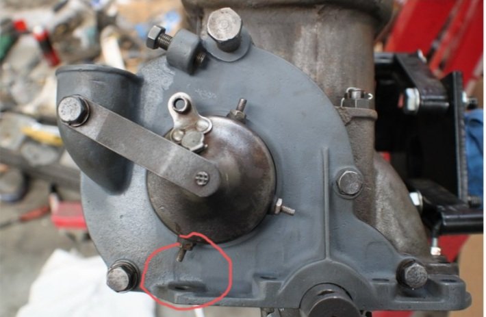

RajoRacer wrote:
Tue Sep 06, 2022 5:28 pm
Dan T. - can't say I've ever seen the reversal of the screws & flag terminals like you did.
Steve
Yep, learned to do that after seeing other's with issues of those large flag terminals or wires pinched there and hitting stuff.
Only the New Day has its terminals facing forward, other timer cases (with exception of the Eagle and Turner Short-Proof) the terminals are concentric with the case. Nice thing is the New Day case is an insulator, so any scrub of wires on it won't cause trouble.
So putting the flag behind the case prevents contact from mal-positioned fan belts, or bolts and nuts in the fly zone of the timer case :D

Re: New Day Timer expectations.
Posted: Tue Sep 06, 2022 7:11 pm
by Ron Patterson
Ford recognized the problem with timer case wiring routing in the and created a solution.\
See attached photos.
