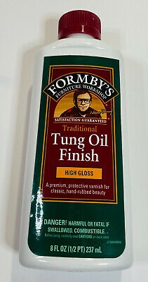

Is your steering wheel made of nicely grained hardwood such as oak, or a mediocre grained wood such as pine or poplar? The question then becomes, do you want a finish that shows off the grain or doesn’t matter? If you have a wood with a beautiful grain, I would use a satin or semi-gloss polyurethane. If you want a little color, I have used an aerosol Minwax satin Pecan Polyshades with beautiful results. The below was downloaded from Amazon. The more coats the deeper the color. Jim Patrick

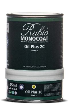

[image][/image]I used this product called Rubio monocoat on a mesquite countertop. Goes on easy and makes an oil type finish without any build-up. A 355 ml can is $52 on Amazon, but a very small amount goes a long way. Flat surfaces you use a plastic bondo spreader, curved surfaces a foam brush works good.

Posted: Mon Sep 12, 2022 8:31 pm
by jiminbartow
Tung oil should not be painted on. I used to use Formby’s gloss tung oil a lot. The best way to apply it is with your bare fingers to give you a beautiful hand rubbed finish somewhat like a French Polish without the rag. Put a few drops on your fingers and with a swiping motion, rub it into the wood until it becomes tacky on your fingers and continue to do this several times (coats) keeping your hand moving in a light swiping motion that will build up the tung oil as it is rubbed into the wood. Once you get the hang of it, you will find tung oil will give you one of the nicest deepest, finishes, possible.
Jim Patrick

I didn't know there was a high gloss tung oil. I used Minwax, it said to apply with a cloth. How do I fix this and get the high gloss? Can this oil be removed?

by jiminbartow
:roll: What kind of Minwax? Stain alone? Polyshades? Polyurethane over stain? The Minwax should be able to be removed with Lacquer thinner. Paint the lacquer thinner on and let it sit and soften the Minwax, then wipe off. Continue to do this until it is all off down to the bare wood. If the stain was applied separately, it should remain, but if some of the stain comes off and lightens the color, I think it would look better. It seems too dark. Once all of the Minwax is off, a hand rubbed tung oil finish, as I described, will give depth to and enhance the grain. A little goes a looooong way. Jim Patrick
PS. This picture is of a newer bottle. The first picture I posted above is a 40 year old bottle.

by jiminbartow
Even though the formby’s tung oil says it is gloss, when applied by hand and rubbed in with the fingers, the finish is more of a semi-gloss. A lot of people don’t like a high gloss finish. Jim Patrick
