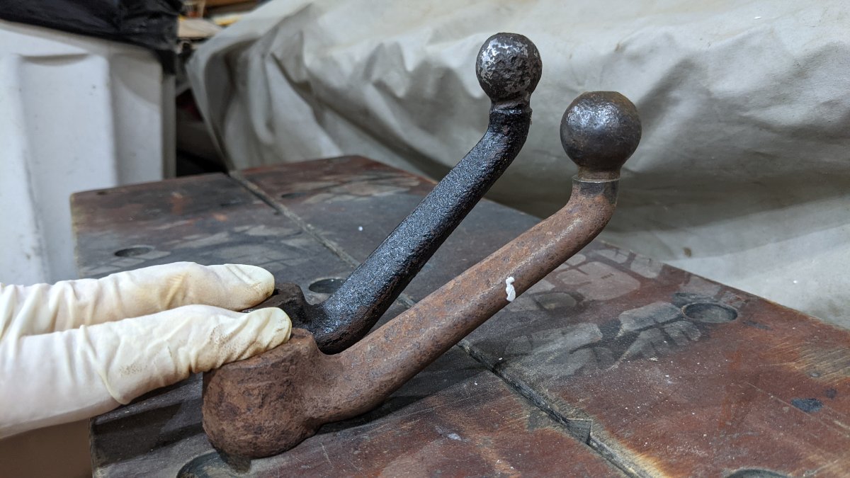

This shows the late pitman arm that was on my '26 Runabout (black with submicroscopic ball) and an earlier, rusty arm with a better ball. You can see the angle difference.

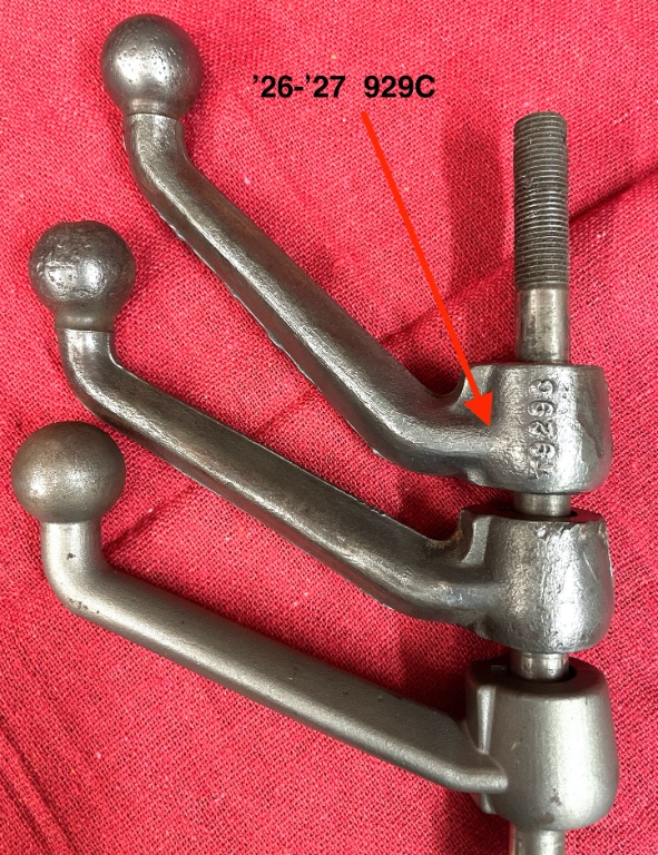

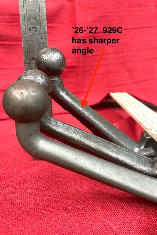

Here's another comparison of ball arms.
The '26-'27 has steeper angle, if you lay it upright, measure to top of ball, should be over 4". The earlier are shorter or shallow in angle.
The factory '26-'27 has casting numerals 929C, that is the Factory Number of the Ball Arm T-3547B
The earlier (about '13 - '25 Ball Arm is T-3547, Factory Number 929B. The reproductions are the 929B shape, repro shown in foreground.
