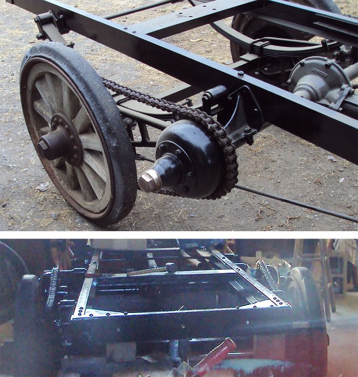

What a great video. I wonder if my Maxwell conversion was a Truckford. The rear of the frame is very similar in construction.
Other conversions mention for Chevrolet, Maxwell and others.
Truckford is very illusive but I did find this FWIW. Not sure what to make of it.
And this:

For Gene. What type of rear end is under your truck unit? A Torbenson, Russell or some other brand? Glenn

For Rich. Your truck unit may be a Maxfer. Maxfer developed the "Bell" style hub which saved buyers of conversion kits the added time and expense of having to remove the backing plates from the T axle tubes. Some smaller companies copied the idea. The best way to identify most any kit is by comparing the axle radius arms and chain tension adjusters. If you would post some pictures especially the other side, I should be able to identify your manufacturer. Glenn

Thanks Glenn. I had forgotten Maxfer. I think it was discussed sometime back. It is a better match to what I have.
