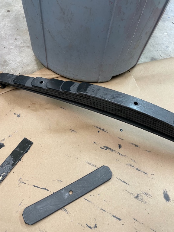

Have at times just used the Slip Paint as primer when the leaves have been stripped with wire brush or disc sander.
On most, with rust pits still showing, that you really don't want to grind away (preserve the leaf metal as much as possible), have then primed the leaves. But my primer choice is Rustoleum Rust Reformer, (spray bomb) it locks in rust pits, dries fast, is durable black primer. Then over that I brush on the Slip Plate. Then dry, assemble the stack. Finally finish paint over the assembled stack with good black enamel.

by Sarikatime
I have been told many years ago to use the paint in the picture. Rebuilt all four of my springs this spring and used this spray again.
