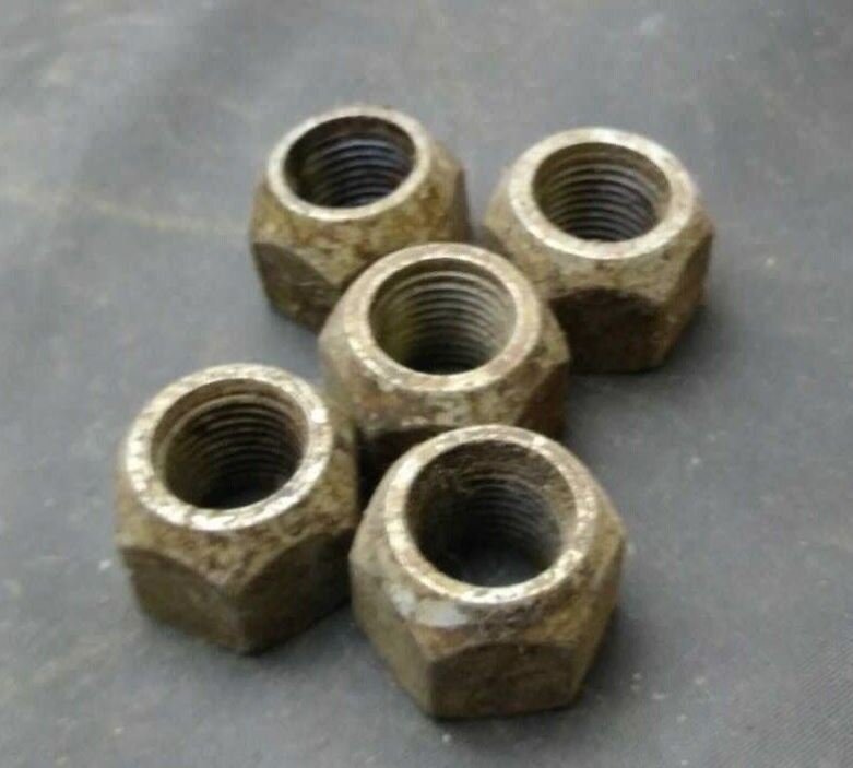

Hello all,
I purchased a set of OEM model t lug nuts. But when I tried to thread them onto my wire wheel hubs they wouldn't go.
Are there Left hand and Right hand thread on the hub studs? (I have a used set that I've near seen mounted)
All the nuts I purchased are stamped with an "L" on them.
Any advice is appreciated!

if there is a place where they will work, it is on earlier demountable wheels ('19-'25), but those are not at all for later wire wheels.

26-7 wires are 1/2 -20 right hand thread. (all).
Those nuts are not the correct style/appearance of original nuts. The L is a big sign they are left hand thread. A good eye can catch the difference between a left or right hand thread.
Thats not to say your hub studs dont need their threads chased if the correct nuts dont go on.

The lug nuts are from WW 2 jeeps. I have a couple of them and would be interested in buying the 5 from you if you are interested in selling them. $1.00 a piece.
Thanks.
