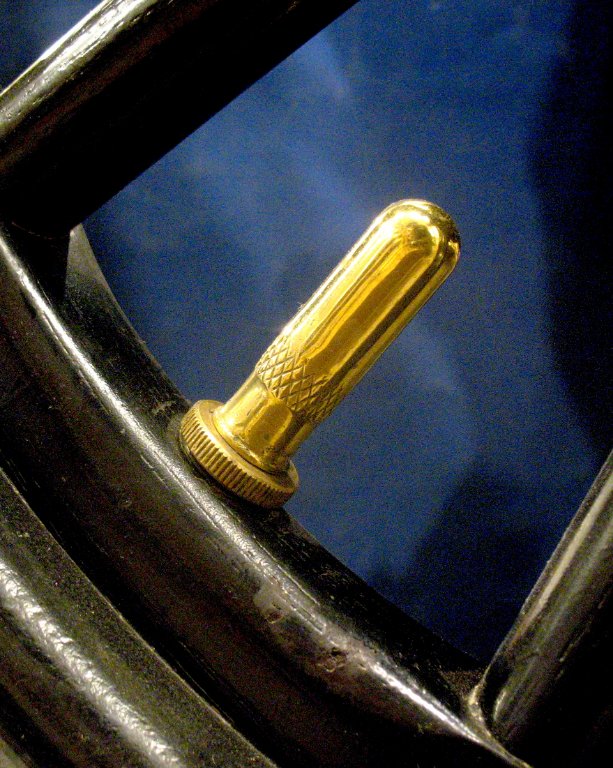

If you look through a box of swap meet valve stems, nuts, and covers, you'll see that there's a large variety, maybe larger than the variety of timers or spark plugs made over the years. I know which stems are correct (Schrader 777), but I'm not sure which of the many covers belong with them. I wanted covers now, not in the sweet by-and-by, so I went with the ones I could find enough of to make full sets. No doubt somebody will be offended by my settling for the incorrect covers (everything offends somebody these days), but I am an insensitive clod and don't care. :)
I use these nickel era covers because they're the ones I could find in great condition.
These covers can be used on the correct Ford stems or the incorrect larger stems I use, depending on which nut is used. These incorrect larger stems are the size used on all of today's metal stemmed tubes.
Schrader 724 stem. Not correct, but it works.
Reproduction brass era covers are made to fit today's incorrect metal stemmed tubes. I suspect they may be correct except for the size of the stems they fit.

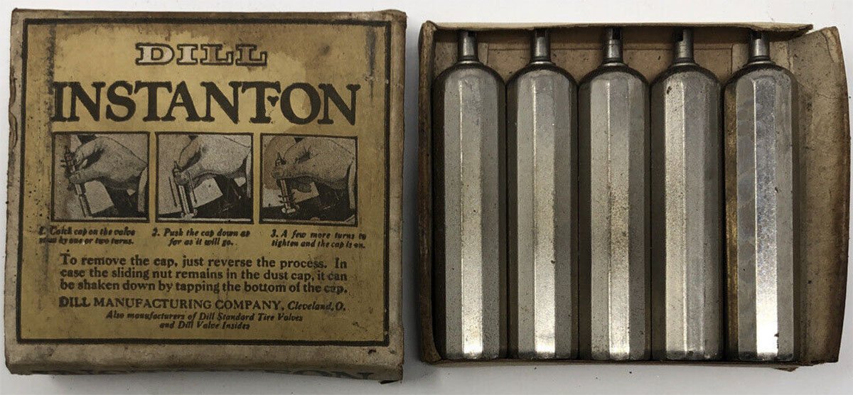

One needs to keep in mind that a valve cap in today's language does no equate with the dust covers of yore. Those dust covers can be fitted over a valve cap.
Dill made a dust cover which incorporated a valve cap, and it is a period correct device which is quite clever. You can even use them on rubber stemmed tubes They have 12 flat sides, and a valve removal tool on the end. The neat bit is the sliding valve cap within. This screws onto the standard small end of any valve stem. The dust cover is screwed on until it begins to bind a little. At this point, the cover can be slid down over the stem to hide it, and the cap tightened to hold the whole in place.
I love 'em!

These may be the type of Dill covers Allen mentioned:
There are more pictures of them on eBay:

The cap can be seen here:

The dust cover that Steve posted looks correct to me. The repros have a slight ledge under the knurl.

I have seen the Ford drawings at the Benson Ford Research Center for the Dill and Schrader style dust covers that Rich posted pictures of, so obviously Ford supplied parts. I do not remember the exact year of the Schrader style drawing, but the Dill style drawing was I think dated 1925 or 1926 or 1927. Both style dust covers were nickel plated, so not right for a 1914 or 1916 T, dont know about a 1910 Buick. The modern brass stem inner tubes have the stem diameter too large for the Dill and the correct small neck Schrader dust cover to fit over, but the larger base Schrader dust cover posted by Steve will fit perfectly and that is what I have on my car. I never tried the Dill style on a rubber stem inner tube but it makes sense they will work provided the stem diameter is small enough.
