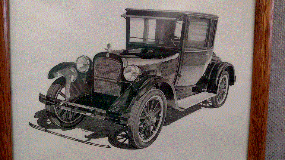

by Mark Nunn
This is a ’24 Dodge Brothers Business Coupe. (This is actually one of my charcoal drawings but I have another photo somewhere if anyone wants to see it. This is a local car that I almost bought.) The body lines are very similar.

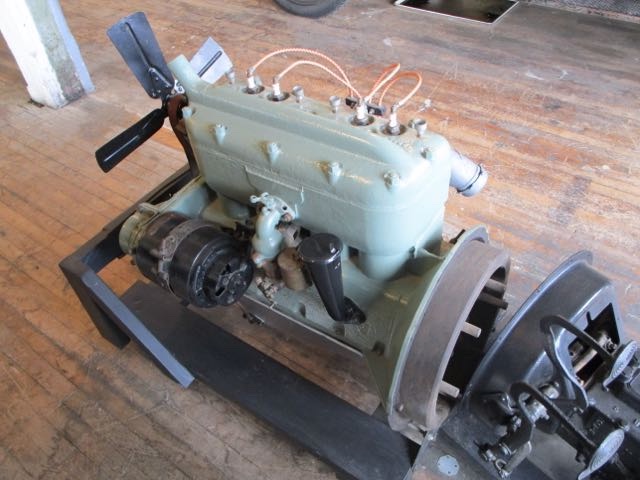

by Gene_French
Les:
defiantly a Dodge Brothers engine and early aluminum transmission … is missing starter / generator unit , but most of the engine components are inplace … always an optimist ...Gene French

by Mark Nunn
This is a 1926 Dodge Brothers sedan. The body is as close to the yard art as I could find.
