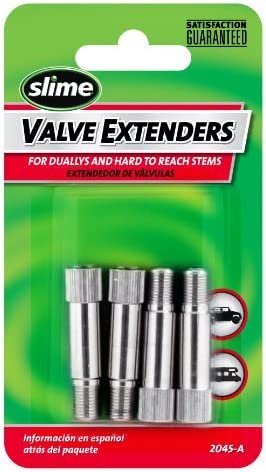

Both Auto Zone and Amazon carry "Slime" brand metal valve extenders. This might be what your looking for.

There are cheap plastic valve extensions available, as shown. They can be most unreliable in operation, particularly with their ability to properly depress the valve core when inflating the tyre. Truck tyre dealers will have precision made brass extensions which are are of excellent quality, but come at a cost penalty.
The Dill cover a Scott shows are an excellent alternative.
