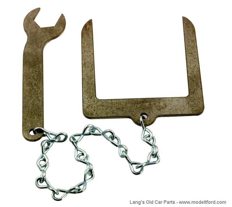

How does this tool mount so that I can take off the brake pedal without tension from the spring pushing the nut and/or washer out, and into the transmission?
Any help would be appreciated.
Thank you.

I bring the ears together so I can unscrew the nut and remove the nut and washer from the pedal shaft. I hold it at a 45 degree angle so each prong sits just under the rearward lip of the band. To be a safe I stuff the surrounding open areas with crumpled paper towels so things don't fall down in the pan.
