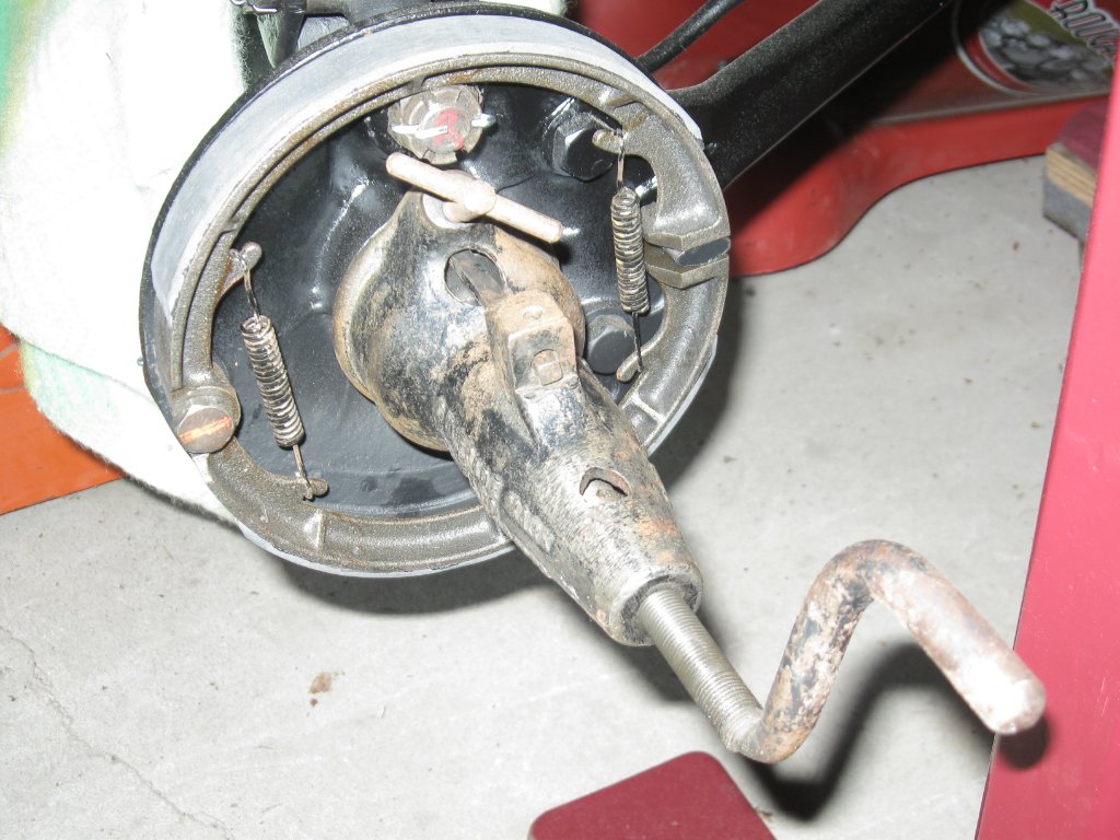

DHort wrote:
Fri Nov 25, 2022 3:30 pm
The old style never wants to come off anyway.
I used to agree with that statement, then I found the right tool for the job:
Re: Why a notch?
Posted: Fri Nov 25, 2022 6:51 pm
by TFan
Well La Dee Da Now I have a new tool to look for. Thanks Pep
Re: Why a notch?
Posted: Fri Nov 25, 2022 7:44 pm
by RVA23T
It would be great to see the inside of the tool when possible.
Re: Why a notch?
Posted: Fri Nov 25, 2022 7:49 pm
by John kuehn
I never thought about what the notch was for. I saw the notch and figured it ought to be lined up with the key way. When removing the cover I tapped around the outside with a ball pain hammer. That would usually loosen it enough to get it to move and then spray behind it with WD40. It would then slip off.
I wooden if Stevens made a tool to use for it. They made one for most other T parts. If they did it’s not common. And if the one pictured or presumably a Stevens tool was found in a box of this and that at a swap meet it was probably passed over because it wasnt recognized.
Re: Why a notch?
Posted: Fri Nov 25, 2022 8:16 pm
by Pep C Strebeck
Not to hijack the thread (too much), I will add a link to a previous post with some more photos of the Dust Cap Puller.
viewtopic.php?f=2&t=9483&p=70586&hilit=cantrell#p70586
It was one of the axle tools made by Cantrell-Miller, I am fortunate enough to have all (both T and TT sleeve pullers) the tools shown, except the Hub Puller and Waste Puller that are pictured below.
