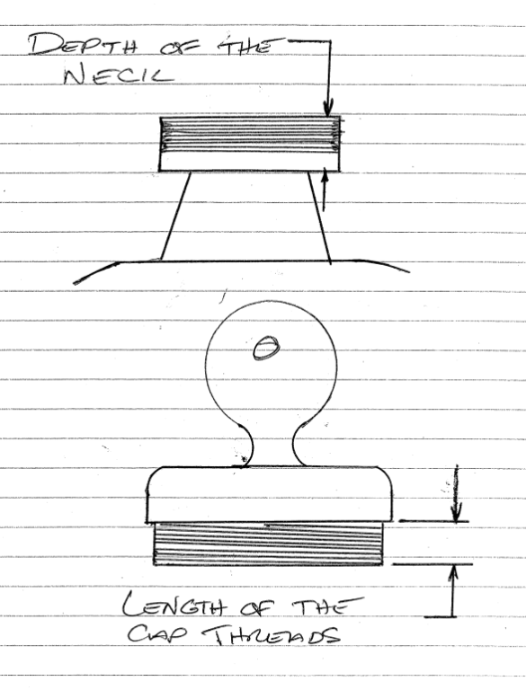

Oh my gosh... His cap tightens up 90 degrees from where it should be. The threads are fine, or it wouldn't tighten at all. He needs more washers under the cap.
Brian,
Measure the depth of your radiator neck, from the top edge, down to the shoulder where the gasket sits. Measure it with no gasket in place. Then measure the length of the cap threads. I'll bet the neck is way deeper than the cap threads are long. The difference in the 2 lengths, is the minimum thickness that your gasket stack should be. In fact, the stack should be just a bit thicker.
Re: 1918 Ford Model T Filler Neck questions

Holy cow I never thought of this. This is probably it exactly. What should I use around the cap threads to block them?

Jerry VanOoteghem wrote:
Tue Nov 29, 2022 2:59 pm
Brian,
Here are some more pictures and hopefully these will help.

If you put enough shims [gaskets] under it, you can make it snug up anywhere you want it to.
YES! Do what Pat says.
If it takes 6, (or more, or less), gaskets to make it work, then so be it. Keep adding gaskets till you get what you want. I don't know how to state it any clearer than that.

by cramagraham
Thu Dec 01, 2022 2:47 pm
cramagraham wrote:
Thu Dec 01, 2022 12:23 pm
Did you see my added pictures? The problem seems that it only bites on the neck threads when its near the bottom of the neck.
I'm not sure that the pictures really show that. Does the regular T radiator cap do the same thing? Can you show a good picture of the moto meter threads?
This I have not even thought about trying which sounds like it might work. Just a regular old clamp with the screw on it? Do you think maybe even a metal ziptie?
