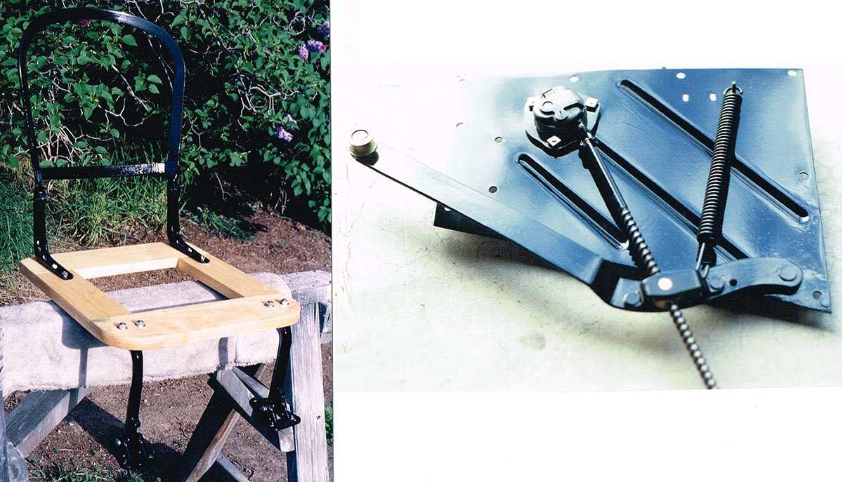

There were some clever and generous folks in the hobby when I started, and I learned a lot from watching them. I enjoy the same kind of people here on the forum now. There is so much to see and enjoy. These projects are full of challenges and fun to overcome.
The passenger seat is unusual in that it cantilevers without any support at the rear. I worried than it might be weak as I found a couple broken frames. However, we have load tested it several times and it is plenty strong. The window mechanisms are odd and hard to find parts for, but I was able to make them functional.

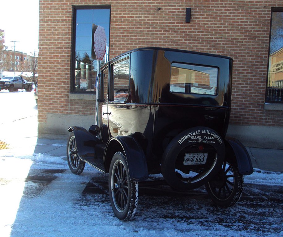

Speaking of the Tudor, we have been driving an old car to our car club dinner banquet for 50 some years now. It used to be popular to take an old car out for it but this year we were the only ones to bring an oldie. It's kind of sad.
Cars 25 years old are eligible yet they did not show up. Still, it was fun to see everyone and share in the Christmas Fun.
