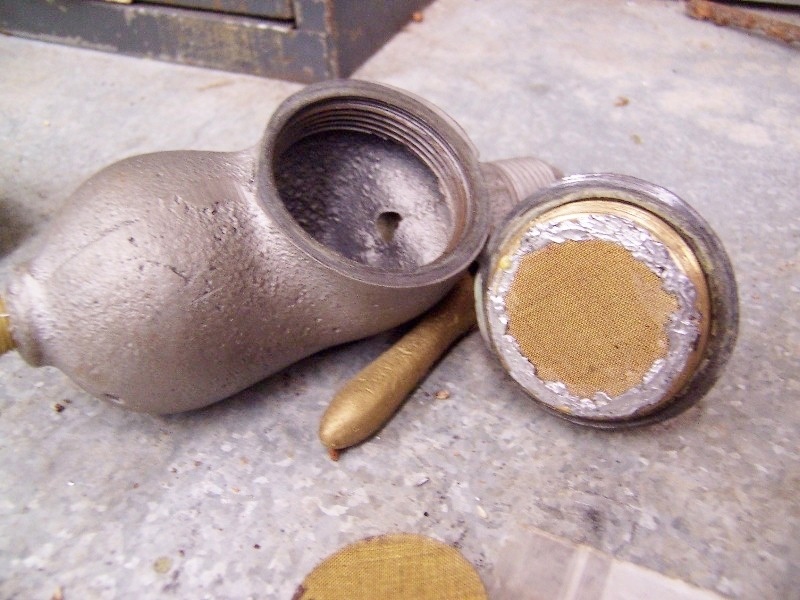

When rebuilding the sediment bulb, replacing the filter screen and cleaning up the bulb, the handle gets polished, then inserted in the bulb valve opening and using TimeSaver, lap the valve body to the iron bulb.

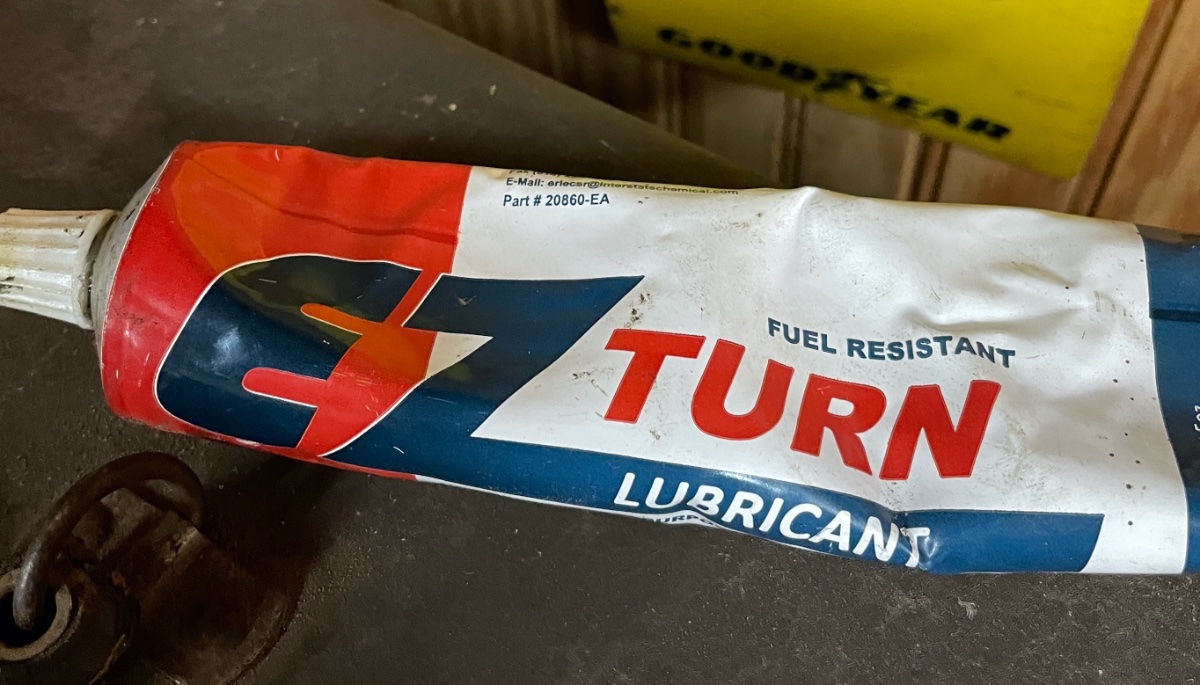

On final assembly the valve body gets a dab of E-Z Turn gasoline resistant lube, as do all petcock, like the gas carb shut off accessory, this stuff works to keep the petcock valve free of dried gasoline residues that make it stick! Using teflon would be a mistake as gasoline disolves that material./b]

I use the exact same process that Dan has described. They work smooth as butter. I also take the pet cocks apart and do the same. I’ve been cleaning up lately and must have a dozen great bulbs they just all have a broken handle.
