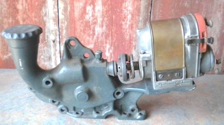

Thats a mag drive, looks like it was intended for a Fordson tractor. The alumn. hogshead is interesting on a motor with a one piece valve cover.
Re: What a timing cover...
Posted: Wed Dec 21, 2022 5:18 pm
by Kerry
After market high tension Magneto mount.
Posted: Wed Dec 21, 2022 5:25 pm
by DanTreace
Type of magneto drive front plate, missing the mag. The engine is a '26-'27, and the hogshead too, note the two bolts and bosses to back of engine block.

The high tension magneto drive is not one I recognize? Bosch, Columbo, and Matco are fairly common. This one sticks out a bit longer which makes it look like maybe Fordson tractor? However, I don't think that it is meant for a Fordson.
Been a long time, I used to have a similar Bosch drive for a Fordson (it said so right on the casting!). But it looks a bit different, and actually stuck out even farther!
As I recall, The one I had bolted onto the timer's position, and therefore could be put onto a model T engine? However, the other mounting bolts were set farther out and it would not bolt straight onto a model T block. I figured at the time that I could make it work on a model T, and did consider using it on a model T. However, I sold it awhile later Other supporting bolts were nowhere near fitting onto a model T block. So my guess is that this one looks like a model T fit as the other bolts don't appear to line up with what I had.
The one I had, I did set onto the front of my engine on the T I had at the time. It stuck out far enough that the magneto would have been sitting over the frame rail and stuck out past the sides of the hood!
If I am wrong, I do hope someone will correct me, as I don't know Fordson tractors that well.
