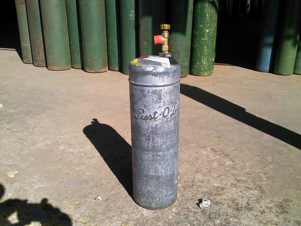

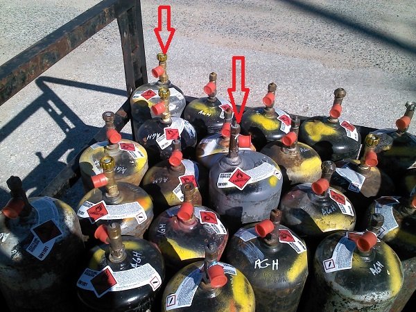

Bryan,
You can still find Prest-O-Lite "B" tanks with the off-set valve. These you
may lay on their side as Wayne says with the valve "up" on the running board.
They do not have the "pressure valve gauge" in the bottom which precludes them
from being filled today. There is a plug where the old "Prest-O-Lite Tank Pressure
Valve" was.

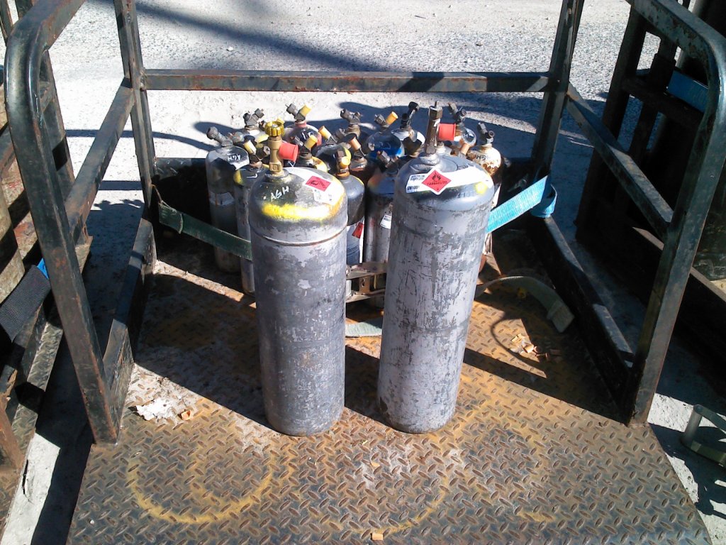

I have found these "more modern" Prest-O-Lite Tanks mixed in with the regular center
valve "B" tanks at both my AirGas and Praxair supply houses. You have to look carefully
to see them when they are mixed with the regular "B" tanks.
Below is a batch of "B" tanks that were at my local AirGas Welding Supply. There were two
Prest-O-Lite off-set valve tanks mixed in. Two arrows. I like the "coarse" knob style
valve because I don't have to fiddle with a "key" to turn off the bottle and it closes faster.
I use a small regulator. Those who "crack" the valve will probably like the old style valve.
The acetylene tanks in my area of Texas are filled about sixty miles from me and I discussed
these tanks with the manager a number of years ago. They replace the old style valves when they
fail with the coarse style with the knurled knob. He said the Prest-O-Lite tanks with the pressure
gauge fail almost every time in the bottom where the gauge is. As long as the POL tests, he fills it.
I keep one on the car and another as a spare to exchange when I find another one.
ARROWS - PREST-O-LITE TANKS
B TANK PILE.jpg (100.14 KiB) Viewed 5745 times
COARSE-LEFT AND OLD STYLE VALVE RIGHT<br />STACK OF MOTOR CYCLE TANKS BEHIND (MC)
COARSE VALVE &quot;B&quot; TANK
COARSE VALVE "B" TANK
B TANK PILE - A.jpg (68.57 KiB) Viewed 5745 times

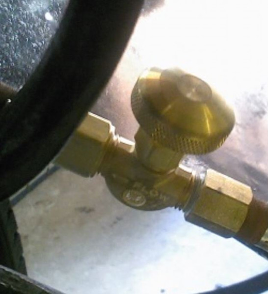

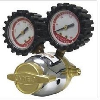

Jerry,
I use a small Uniweld Regulator on a Prest-O-Lite "B" tank.
I'm sure the welding supply can set it up on a Motor Cycle tank.
I set it to about 4 to 5-psi. Then the small Radnor acetylene valve
(located between the radiator side panel and each headlamp)
allows you to set the flame right where you want it on each headlamp burner.
There is only a short piece of acetylene hose between the Radnor and burner base.
Once you set the flame, turn the headlamps "on/off" by opening or
shutting off the acetylene tank. Makes it real easy to light up without
having to set everything again.

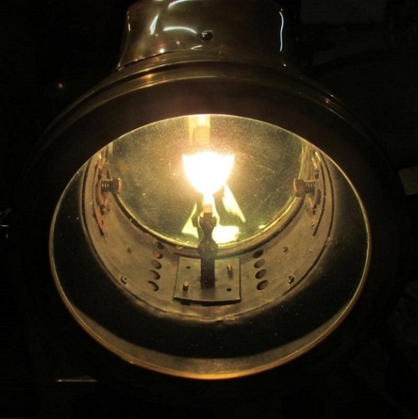

Keith made the best photograph of a lit headlamp, see below!
That is what you are looking for....
Just set the Motorcycle Tank valve "up" to keep the acetone out of your
small regulator. They were made to lay horizontal across the handlebars of motorcycles.
Most supply house folks don't know why they are called MC tanks or B(us) tanks.

Thank you Keith T for the draw-down cautions and experience with the MC tank.
Also, DO NOT enclose these fuel tanks in tool boxes, non-working carbide generators,
under touring car seats, or any other enclosed or poorly ventilated areas!
Keith T's last post at 10:00 a.m. is spot on.
I went by Airgas this morning and he only had eight regular center valve "B" tanks.
He said he had several Prest-O-Lite's last week or so but if I would leave my number,
he would pull one when Western International Gas makes their next delivery of "B" tanks
with a Prest-O-Lite in it. He also offered to chase one down for me using the picture
I posted above in this thread of the Prest-O-Lite tank. Western International Gas is an
acetylene filler and supplies all over the U.S. and currently are filling them.
While at Airgas, I checked today's cost on acetylene tanks, refill charge and both include tax.
1. Prest-O-Lite "B" tank (including gas)........$202, ......Refill your POL....$46
2. MC tank (including gas).......................$124, ......Refill your MC.....$32
Carbide is fun but expensive today.
You can refill your POL "B" tank 3-1/2 times for the cost of the
amount of carbide to produce 40-cubic feet of acetylene gas (10 pounds).
