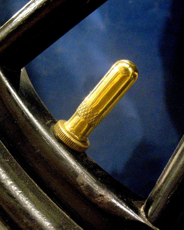

Some dust covers screw onto the rim washer and some screw directly onto the stem. All of today's metal stem tubes use the larger sized stem not used by Ford. I believe all the reproduction dust covers are made to fit that larger sized stem.
This reproduction cover is an excellent copy of originals I've found at Hershey.

The reproduction dust cap posted by Steve Jelf is an original.
