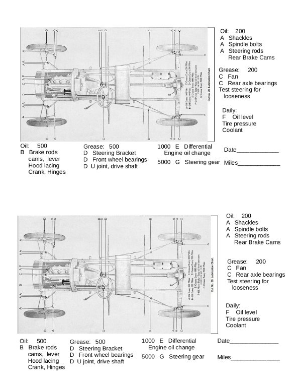

I keep it as a PDF and print it on 8½ x 11 card stock to be cut in two 5½ x 8½ cards.
LUBE CHART.pdf
(199.02 KiB) Downloaded 144 times
