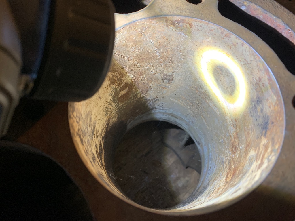

Here’s a better picture of the cylinder bores.

For those wanting to know the bore measurements of the cylinder holes:
#1- 97.62mm
#2- 97 mm
#3- 96.71 mm
#4- 97.20 mm

METRIC!!!!!!!!.
If my conversion is correct, #1 is 3.843 INCHES. Thats .090 over bored. Needs sleeving.

by TXGOAT2
I'd be concerned about remaining wall thickness in that block, besides everthing else mentioned.
Isn't there a method of testing castings for minimum wall thickness? The radical overbore combined with water jacket corrosion and normal casting irregularities might condemn the block. As for the exterior corrosion, heating the block in a furnace and spray welding cast iron to the affected areas, then remachining, would take care of that. The block would probably need full remachining after such treatment. The expense would be considerable, and the results might not be fully satisfactory. I'd look for a better block, and keep this one for possible rehabilitation in the future. There are a few people left who can do amazing work repairing old castings. There are many more who only think they can.

If the bores are tapered or out of round, which is very likely, it will require further boring to do a proper sleeve job. If the block has been rebored with the type of portable boring machine that has to be moved from one cylinder to the next, it's possible that the bore centers are no longer regularly spaced, which would further complicate sleeving.
