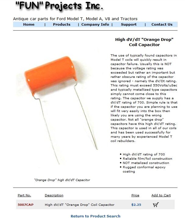

Those older capacitors in the photo are .047uF. That is way too low of a capacitance value. It should be about ten times that; i.e., .47uF.
Aside from that, the dv/dt rating is most important. This is the rating of how quickly the voltage across the capacitor can rise in a given amount of time without destroying it. The dv/dt rating needs to be at least 600V per microsecond. This is not the same as the ordinary DC working voltage.
The DC working voltage needs to be at least 400V.
The Sprague Orange drop capacitors which were being sold around 20 years were suitable, as was a smaller capacitor which later came from Fun Projects, which had a dv/dt rating of 1500V/us.
This is an early catalog listing when FP was still selling the Sprague capacitors:
See this data for the Sprague capacitor - the appropriate type is 418P47494M.
capacitor418P.PDF
(110.68 KiB) Downloaded 88 times
