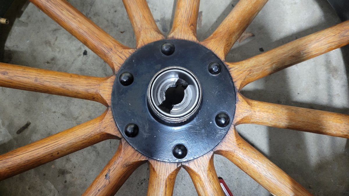

While I had the wheels off to replace my spindle bushings, I figured I would install my front bearing set.
The old bearings came out easy and the races needed some persuasion. It wasn't a brutal fight as some describe, but definitely required a creative tool and some hammering. It took about 10 minutes for the driver's side.
With that behind me, I got my new races out of the box and I was surprised that the inner race slipped right in and was loose. I tried the outer and had the same result. Here is a video: https://photos.app.goo.gl/C1FAykr3P5vMSTYZ6
I tested the gap with a feeler gauge. I was able to force a .010 into the gap but not a .015. Given the curve of the hub and the width of the gauge, I'm not sure I can get a better measurement.
Well, that's not supposed to happen. Do I need new hubs (yikes!)? I searched the forum and saw some people used a Loctite product but I wanted to put it out there to you all. Have you used Loctite or some other solution? Thoughts?

Thanks for the reply 2nighthawks... The inner race is loose too and it has the part number stamped on it. Looking at Langs kit, this is the correct race.

The inner races can be a loose fit and still need to be driven out. The hub bore only wears where the race sits, and not where the hub seal goes. So, you'll need to tap out the race to get it past the seal area. It makes you think the hub isn't worn...
Old races may seem to be tight in old hubs that haven't been used in decades. Sometimes, it's only the dried-up grease and oil that has them "glued" in place.
Outer races may also seem to be snug when you remove them due to small burrs and other abuse that rolls over metal at the nose of the hub. Pushing out the old race, forces it over these spots, making things seem snug/tight. Once the old race pushes these high spots back, and without those same interferences in play, the new race simply drops in.
The old races can also be split, or maybe even swollen, by overly tightened bearings or previous accidents.
Driving out old races unevenly by allowing them to get cocked in the hubs, can swell the hub and ruin it.
For loose inner races, I have carefully closed up the hub bores by repeatedly hammering the outside of the hub with a ball pein hammer. With the hub firmly supported by an anvil, or other significant hunk of metal, I beat on the hub repeatedly while slowly rotating it. Don't hit it too hard or you'll get the hole out-of-round! Many small hits and lots of patience does the trick.

I noticed the "split" in the old races and incorrectly assumed they were meant to be that way. Well, after a more careful look and clean up, I'm realizing they are the same type of timkin races that I bought from langs but broken.
I haven't done the passenger side yet but I quickly looked at the old races installed on the hub and they appear fine.
A replacement hub is looking more and more in order, but maybe I only need the one.

A split bearing ring normally is caused by an excessively loose mounting fit. The outer ring in this application must have an interference fit.
If the new bearing is installed with an adhesive, care must be given to maintain acceptable wheel runout, mostly wobble. As Scott commented, this would require a lot of skill.

I suspect the split race, or a previous split race, allowed your hub to be expanded. It's also possible the hub is cracked. A better hub would be the best choice, epecially if the car is expected to be driven much.

I'm happy to say that the passenger side is behaving more normal. So far I got the inner race out and it was a bear. The races aren't cracked either. I'll pull the outer this evening.
I checked the new inner race and it doesn't slip into the hub.
Hopefully this hub is in good shape.
Mid extraction:
Time to let my arms rest:

The outer passenger side race was harder to get out than the inner race and only because I couldn't get on it with any tools I had. Inspired by Dan Treace's post from 2015, I went to a local swap meet and bought some inexpensive tools. Then I hit the grinder. The end result was this:
Which led to this:
The next step will be to clean up the hub and insert the new races.
I'm still in the market for a replacement hub for the driver's side. If you have one you are willing to part with, please let me know.
