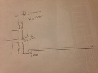

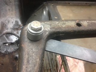

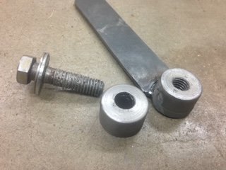

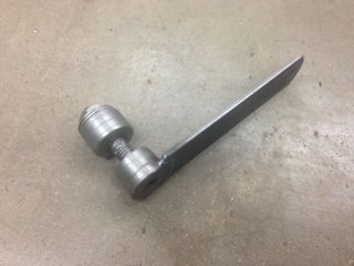

Steve is correct the Right Stuff sets up way to fast especially if trying to install in the car. I used it once on a rebuild and years later I broke
a low drum. Tried for hours to get the hogs head off with out damaging the pan. Finally I left the engine hanging from the hogs head from the
hoist over night. It was off the next day but would have been impossible in the car!
John has a good point also about the dimples. If you hammer & dolly the dimples flat you will need a pan anvil to make sure it is flat after.
I made a simple device to straiten the dimples that can even be used in the car for the pan if the hogs head is remove in the car.
Use lots of never-seize no the threads. Takes time but I have never smashed a finger with it.
