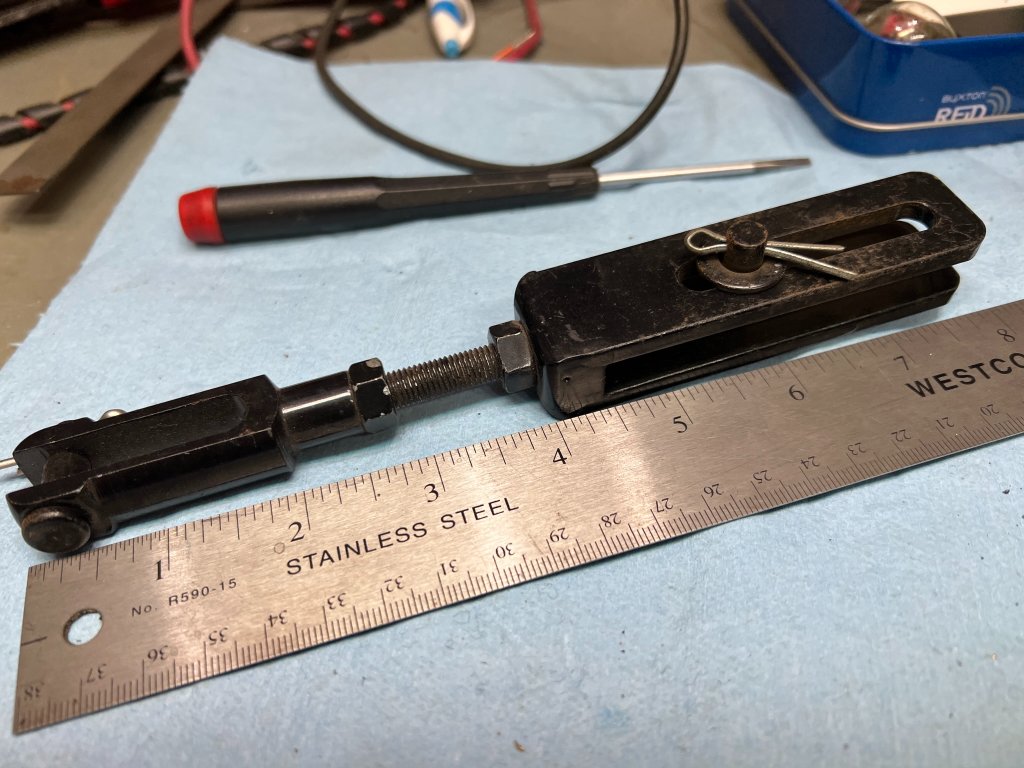

Anyone have the measurements of this by chance? I have an older set of Rocky Mountain brakes I would like to update.

Our best Model T suppliers stock them for around $20. It sounds like you might be wanting to make one yourself. Heck- you can't make a homemade one for that little bit, if your time means anything. But, if you are like me, you may want to just to see if you can. :lol:

If it was twenty it would be a no brainer, but its over sixty and I can make one pretty easily.

It's 7.75" overall length

that appears to be a square nut,some flat plate,some threaded rod,a nut and some other stuff.about a hours work. I aint never made 70 bucks a hour! :D

I made it out of scrap I had in the metal pile, It took about an hour. That’s an easy way to save sixty bucks. Im glad the parts suppliers have them for folks that can’t make them though.

I’ve made a few of these. I increase the adjuster size from 5/16” to 3/8”. 5/16” all thread is down to almost 1/4” at its root with 18 stress risers per inch. I use a quality 3/8” SAE stud for far greater strength because, it’s brakes.

I also built one. I also used 3/8 threads. If I remember right, I think the one that came with my brakes was only 1/4 inch and looked weak to me. It's a "pushing, not pulling" part. I have seen the smaller threaded rod bent.
