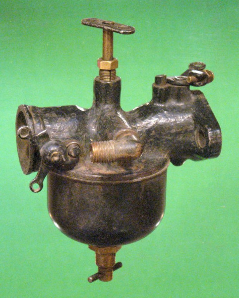

I'm not familiar with the carb that's on your car now. If it's a "correct" one for 1910, it's a scarce item and a rebuilt replacement may be hard to find (or to pay for). The late Stan Howe was a specialist in early or rare carbs. Since we lost Stan I don't know if there is an early carb specialist, but there are other carb rebuilders. Maybe Russ Potter. He does oodles of later carbs, and his customers brag on the quality of his work, so I would ask him.
The Holley NH recommended by John and Scott was used on Fords during the years of peak production in the twenties, so it's very plentiful, and less expensive than most other Model T carbs. I have bought NH bodies or complete carbs at swap meets and auctions for $20 or less. As the other guys have said, it's simple and reliable. You can buy it rebuilt from one of the parts dealers. You can also get the MTFCA Carburetor book and do the work yourself. Nearly all the parts are available new. If you decide to go that route and need a new float valve, get one of Scott's.
The Holley G Scott mentioned is less plentiful but still not hard to find. I've bought it in need of rebuilding for under $20, like the NH. But I've also seen it in need of rebuilding for over $200, so be careful. Some say it's as good as the NH, and some say it's better. Before 1919 it was made of bronze, and when you clean it up, Dang, it shore is purdy.
Holley NH. This one needs a new paint job, but it works.
Holley G. Before 1919 it's bronze.
